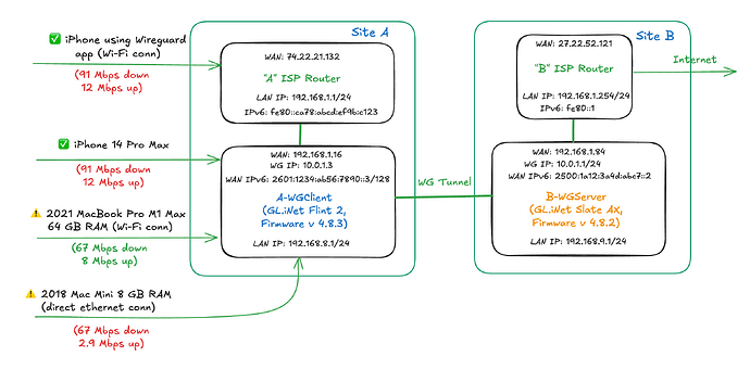

I am facing a bizarre performance issue with my Site-to-Site WireGuard setup.
The Gist: My WireGuard tunnel is capable of full speed (proven by my iPhone), but my macOS devices—especially when connected via Ethernet—are getting unusable upload speeds and "stuttering" connection performance.
The Hardware Setup
  • Site A (Client - US): GL.iNet Flint 2 (MT6000)
    • Connection: IPv6 Native (Spectrum).
  • Site B (Server - Asia): GL.iNet Slate (AXT1800)
    • Connection: IPv6 Native (ISP uses CGNAT for IPv4 that's why I'm forced to use IPv6 VPN).
The Problem: Device Discrepancy
I have performed side-by-side tests connecting different devices to the Site A Flint 2 (Client Router).
All devices are connected to the Flint 2 (LAN or Wi-Fi) and routing traffic through the WireGuard tunnel to Site B.
Device Connection Type Download Upload Experience
iPhone 14 Pro Max Wi-Fi (5GHz, 80MHz) 91 Mbps 12 Mbps Smooth
MacBook Pro M1 Wi-Fi (5GHz, 80MHz) 67 Mbps 8 Mbps "Stuttering" speed test
Mac Mini (2018) Wired Ethernet 67 Mbps 2.9 Mbps "Stuttering" speed test

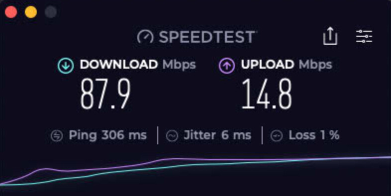

Ok simply downloading Speedtest app on Mac Mini and MacBook seems to match the speed I see on iPhone.
