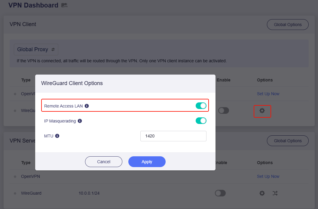

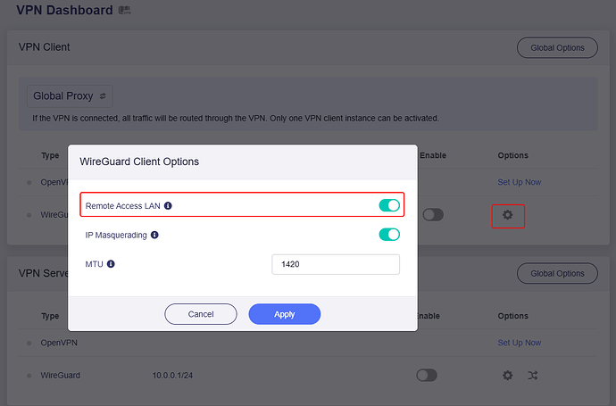

  1. On X300B, enable Allow Remote Access LAN
    VPN Dashboard (Firmware v4.7 and earlier) - GL.iNet Router Docs 4

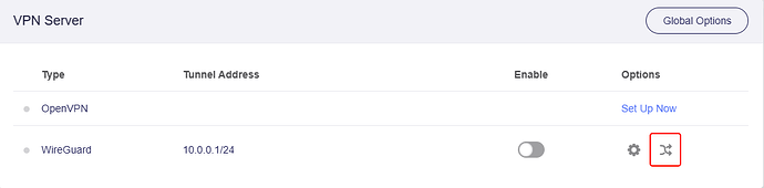

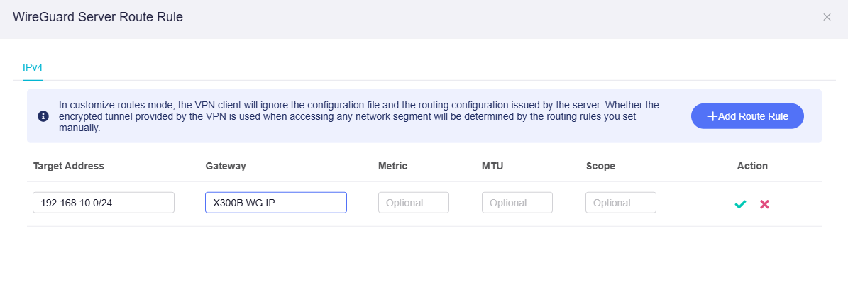

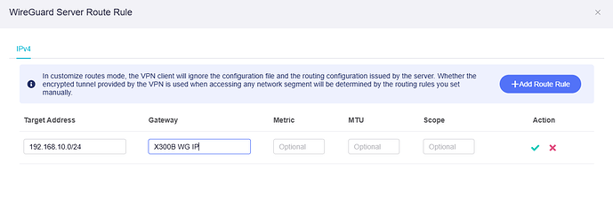

  2. On MT2500, manually create a new route, Target Address is the X300B LAN subnet, like 192.168.10.0/24; Gateway is the X300B WG tunnel interface IP, like 10.0.0.2:
