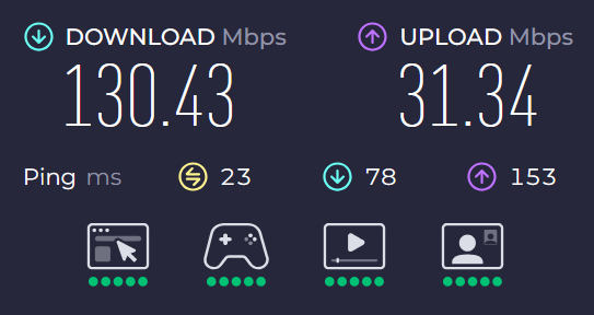

Hello, after updating firmware i finally force my RM520N-GL to work with Slate 7. But first test are very disappointing, speed is at best 30 mbits/s better than when i connect SIMPoYo uFi witch is 4G. I also tested same sim card with mobile router ZTE MU5120 and got 600-700 mbits speed in the same location. BTS is like few hundred maters in straight line with n78 5G band. So all paramaters looks good:
Are there any setting witch i can change to make speed better?

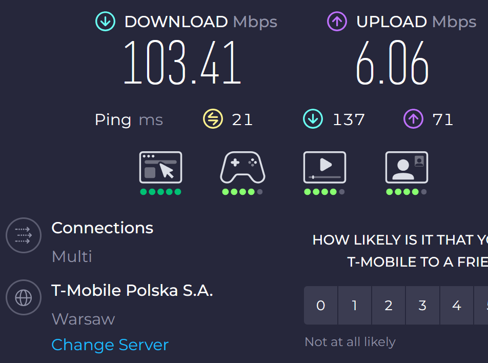

So i ran some speed tests today and what i got is:

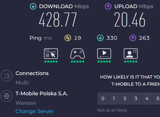

Then i used the same sim card in my ZTE MU5120 placed on the same spot and the result was:
So clearly there is some hardware/software problem on router-modem side, not mobile operator. Any ideas where to search fix?

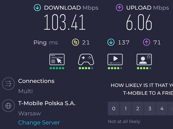

So today i did more tests. Results below,
RM520N-GL modem connected to Slate 7:
RM520N-GL modem connected straight to my laptop via USB:
Clearly there is some problem. Maybe USB port speed on router?
