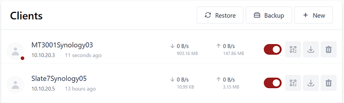

As you see the separate Slate 7 Pro & MT3000 clients sessions. The MT3000 is working and transferring data. Slate 7 Pro is not.
Thank you for the update. We can see that the MT3000 and Slate 7 Pro are using separate WireGuard client sessions.
The Slate 7 Pro connection is established but has very limited traffic.
