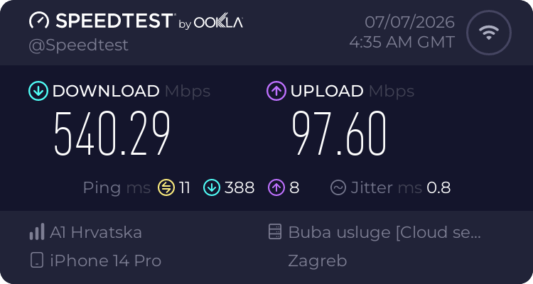

Hello, bought recently Slate 7 Pro and wanted to test it on hotel wifi in repeater mode.
However speed dropped to unusable after some time after enabling repeater mode. I tried to do a reset and speed was fine just after restart, but soon dropped again
Device firmware: 4.8.4
Speedtest results:
Strangely ping in repeater mode is huge

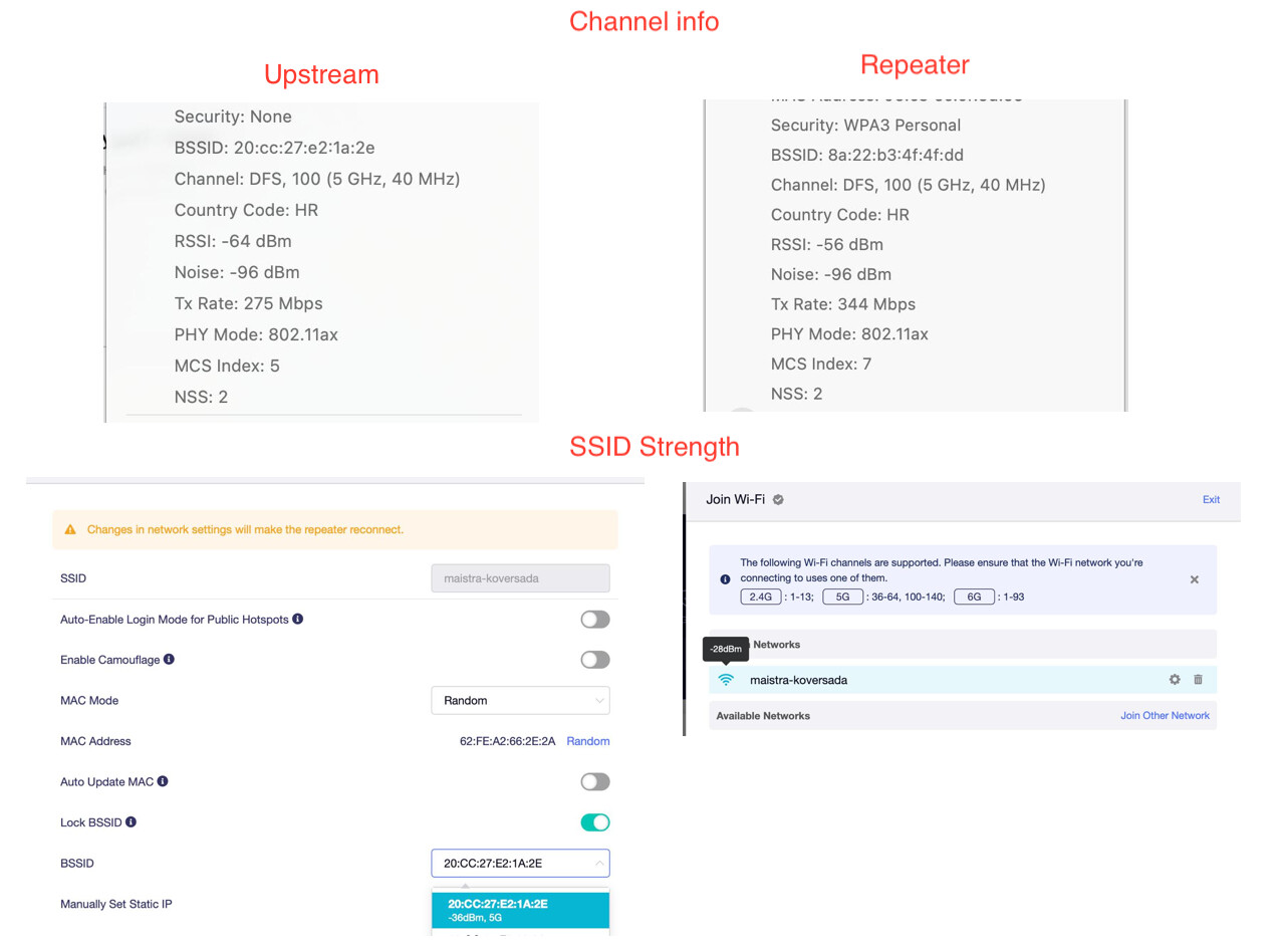

When a PC is directly connected to an upstream WiFi network, what channel does the upstream WiFi network use?
Do you have VPN, tailscale, Tor or similar functions enabled on your router?
What is the signal strength of the upstream WiFi network that the router repeater is connected to? Can you check the current WiFi signal strength by enabling Lock BSSID?
The system log in the attached log file is blank.
Hi Lukas,
Thanks for your reply.
I wasn’t able to get channel info from phone, so used laptop this time:
Upstream connection:
I’m not using any VPN/TOR on router
Sorry, I didn’t check logs prev time, I was using log export and system log was strangely empty, here is new log export
logread.tar (384.5 KB)
