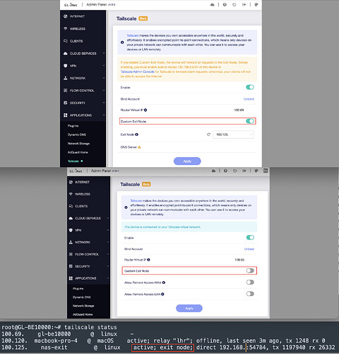

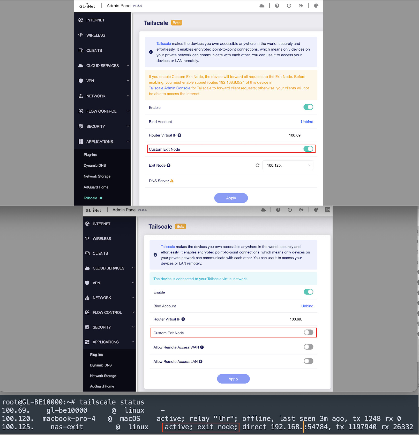

On a slate 7 pro, turning of routing traffic via a tailscale exit node doesn't turn it off. It looks like it worked in the ui but the exit node is still used. This script actually disables traffic from being routed through the exit node for me

When tailscale is running and an exit node is used to route traffic, then in the UI I turn off routing traffic via the exit node (but tailscale is still being used), traffic continues to be routed via the exit node (confirmed with tailscale status).

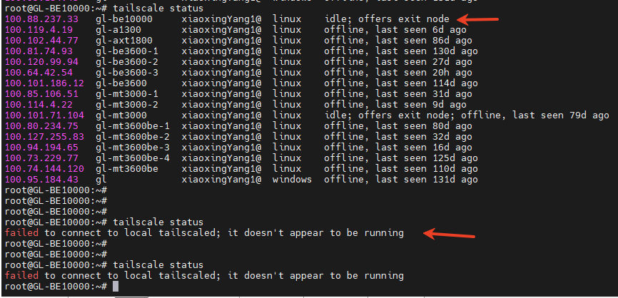

Are you setting the BE10000 itself as the exit node?
Or are you simply enabling a Custom Exit Node on the BE10000 and setting other devices as exit nodes?
If I set BE10000 itself as an exit node, when I disable tailscale in the GUI, executing tailscale status only shows a message indicating that tailscale is not running.
If it's the second scenario, nothing changes.

First I setup tailscale to connect to an exit node that isn’t on the BE10000.
Then I turn off routing traffic via the exit node (but keep tailscale connected)
The UI says the exit node isn’t being used but running tailscale status confirms traffis is still being routed via the exit node (it shouldn’t be)
We've conducted multiple verifications based on this issue, including changing the exit node device, but the problem doesn't seem to be reproducible.
If we disable the custom exit node on the BE10000,
it should normally look like this.
However, the screenshot you provided does seem to have a problem. Can this problem be reproduced reliably in your environment?
