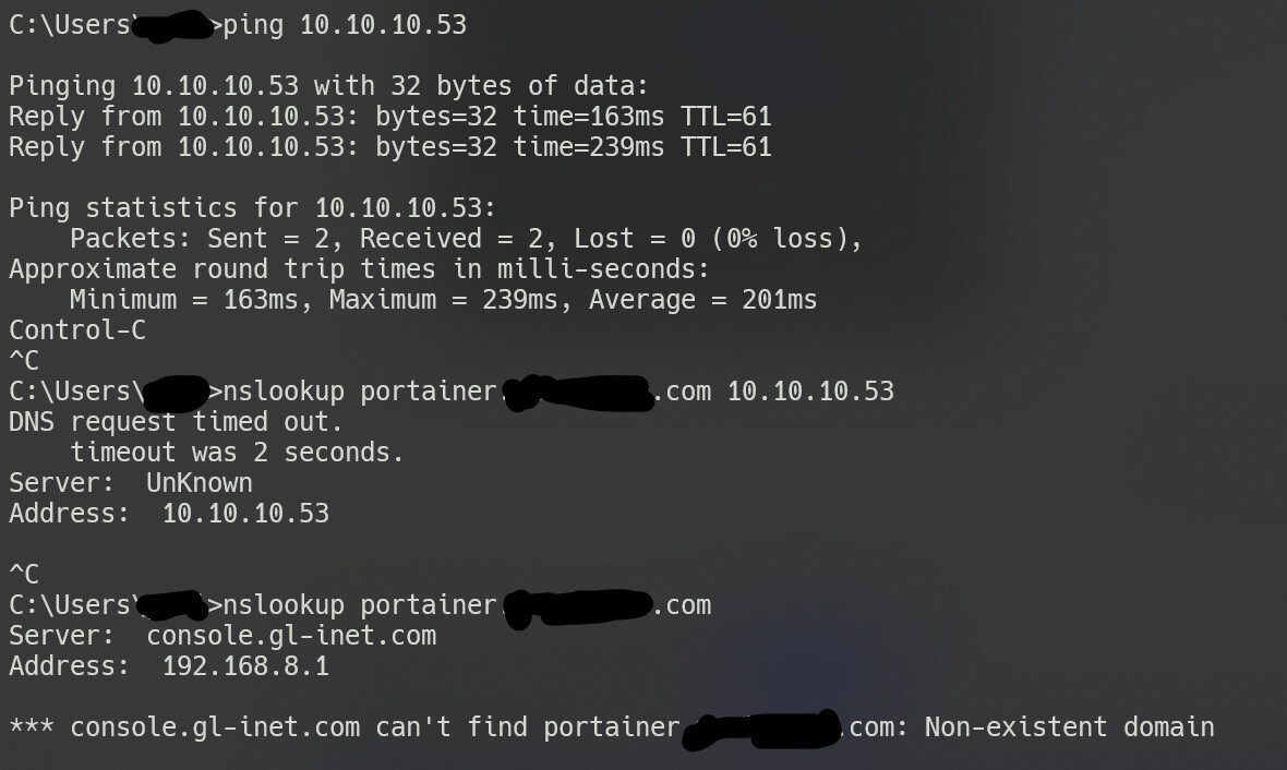

I can’t get any of my SlateAX clients to use the DNS from the tunnel, even if i try to nslookup directly to the servers.
Here are some screenshots:

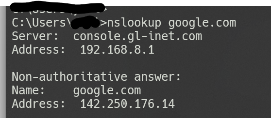

I can ping the server over the tunnel. But can’t nslookup directly to it. I’m trying to resolve a name that is configured in my DNS server to resolve to a local IP in the LAN.

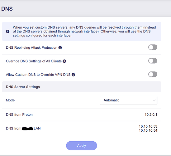

The tunnel is properly configured to route any 10.10.10.0/24 addresses to my wireguard tun.My DNS settings are set to auto: (I tried override, allow custom, and even setting it to manual 10.10.10.53.

Just to be clear, normal DNS still works. I can browse the internet just fine. its just that resolving names form my pihole server doesn’t work

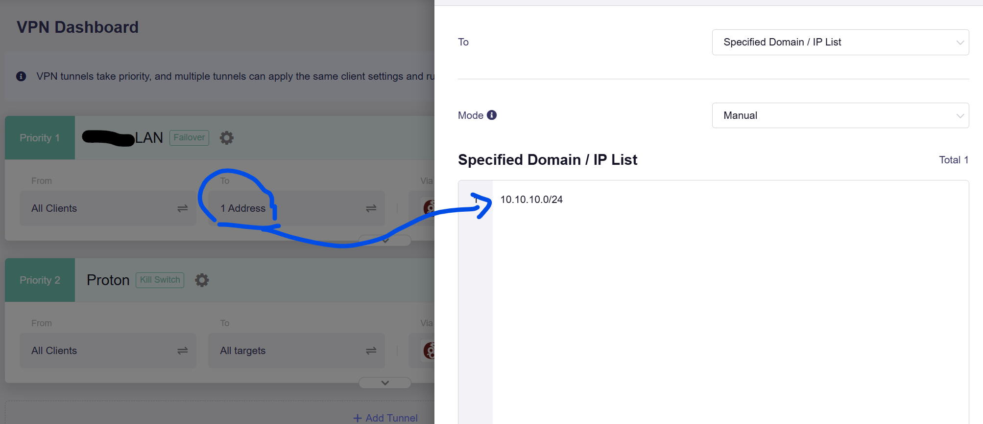

First switch to Global mode, to reduce the variables, only use the ***LAN tunnel, and then test:
  1. Is the DNS server 10.10.10.53 resolution normally if test in the server router LAN client?
  2. Is the DNS server 10.10.10.53 resolution normally if test in the Slate AX SSH terminal?
The problem seems to be on the policy based routing.
If i set my VPN to go "All Targets" to my wireguard, and disable the proton VPN, i can resolve the dns names. If I change it to "Specified Domain / IP List" and set it to 10.10.10.0/24 the name resolution doesn't work. Even though my DNS is set to 10.10.10.53 which is within that subnet range

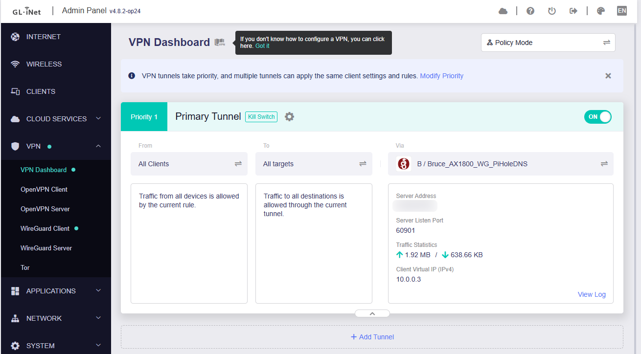

I tested it locally and indeed be reproduced.

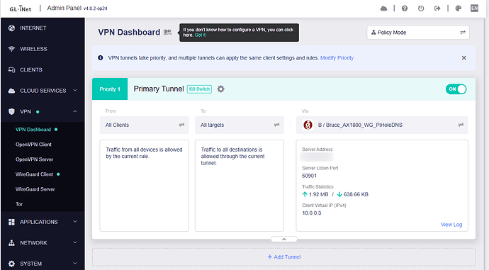

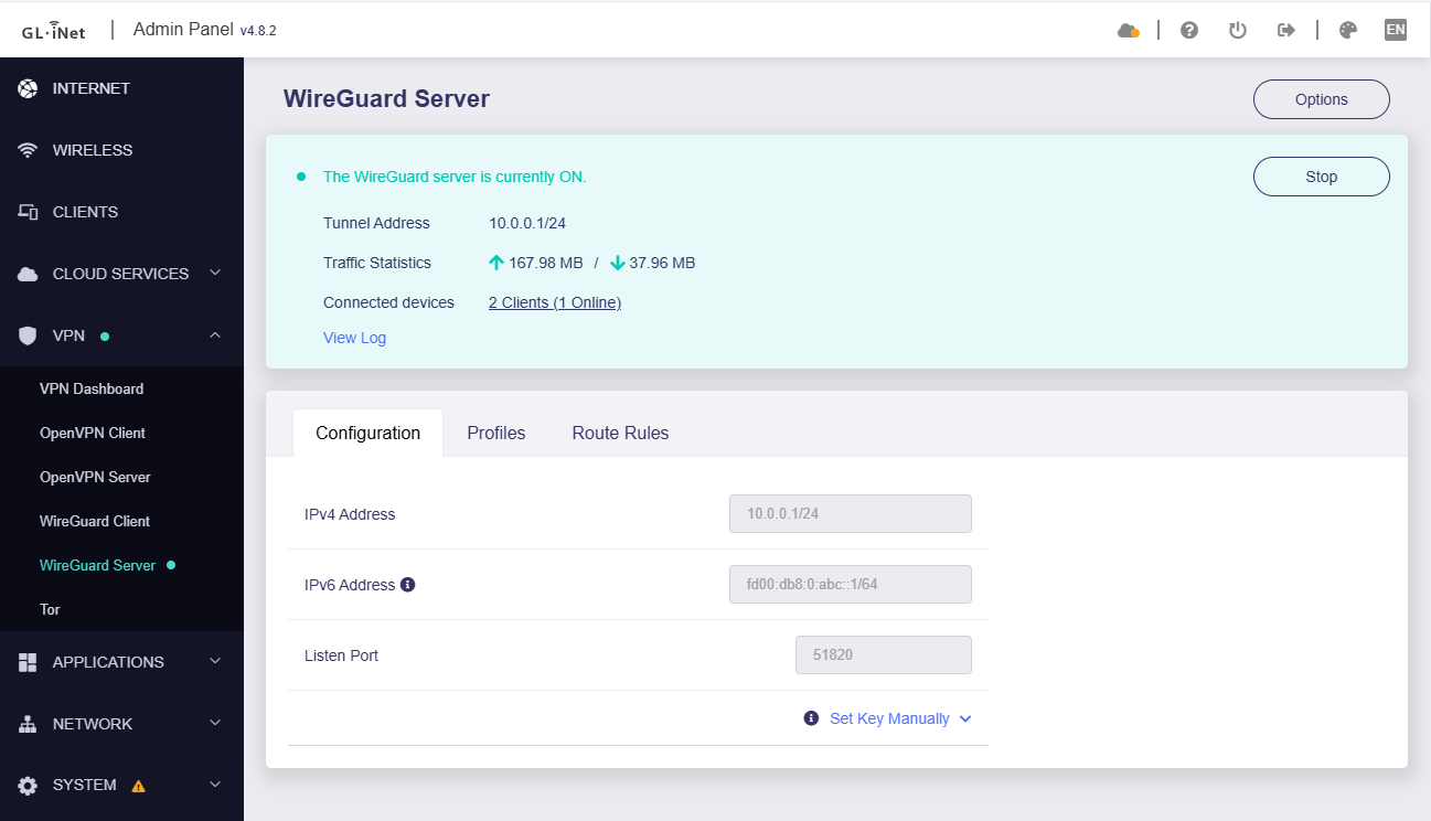

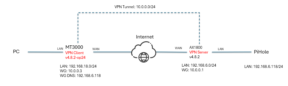

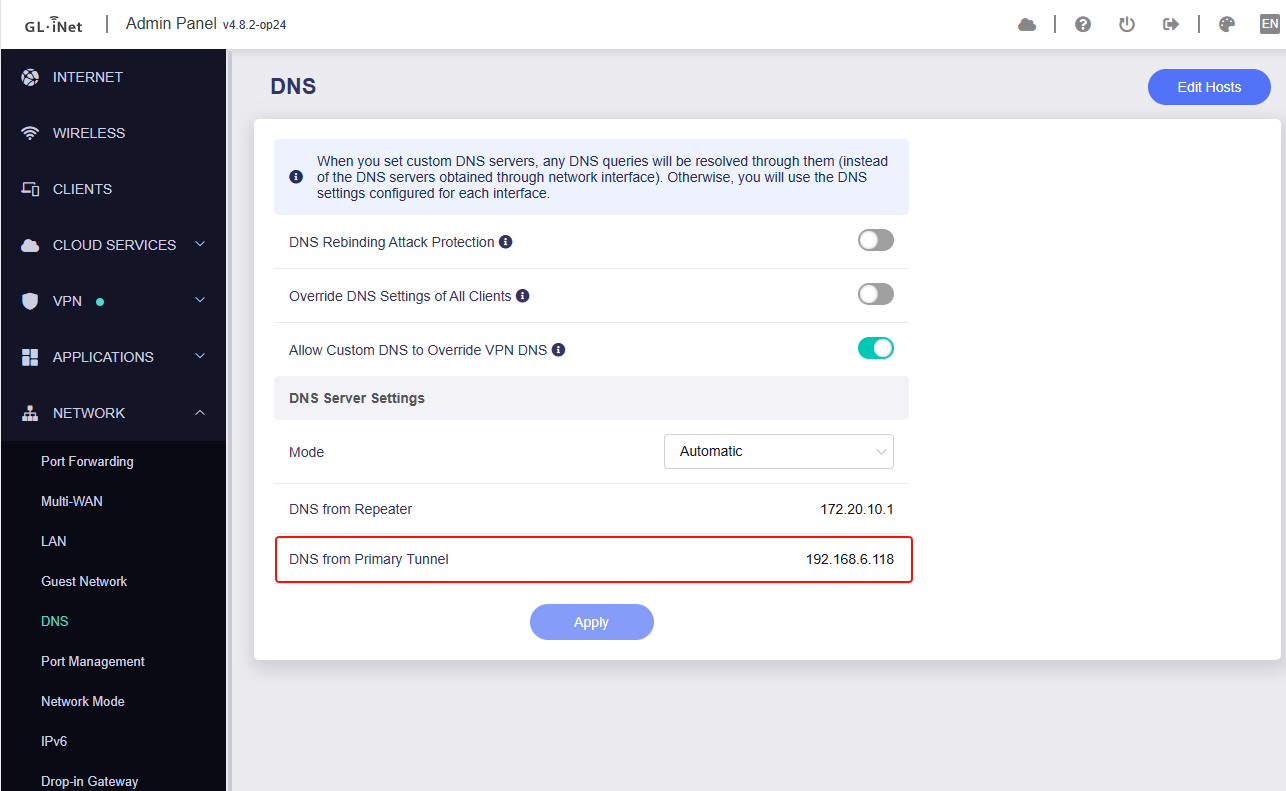

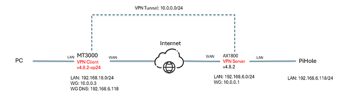

My test topology:
VPN server, AX1800:
VPN client, MT3000:

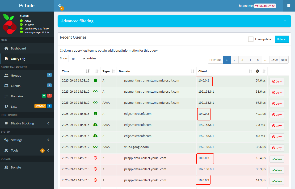

C:\Users\itwuh>nslookup www.qq.com
Server:  console.gl-inet.com
Address:  192.168.18.1
Non-authoritative answer:
Addresses:  121.14.77.221
          121.14.77.201
Aliases:  www.qq.com
C:\Users\itwuh>nslookup www.qq.com 192.168.6.118
Server:  UnKnown
Address:  192.168.6.118
DNS request timed out.
    timeout was 2 seconds.
Addresses:  121.14.77.201
          121.14.77.221
Aliases:  www.qq.com
C:\Users\itwuh>nslookup www.qq.com 10.0.0.1
Server:  UnKnown
Address:  10.0.0.1
          121.14.77.201
Aliases:  www.qq.com

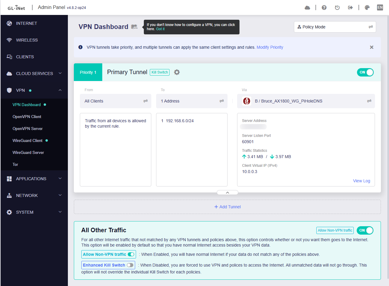

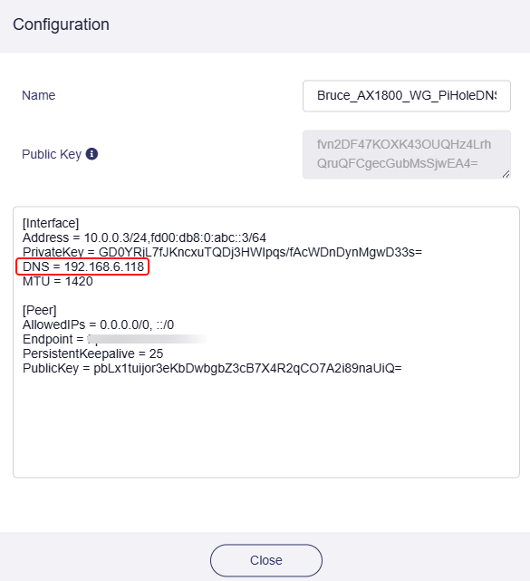

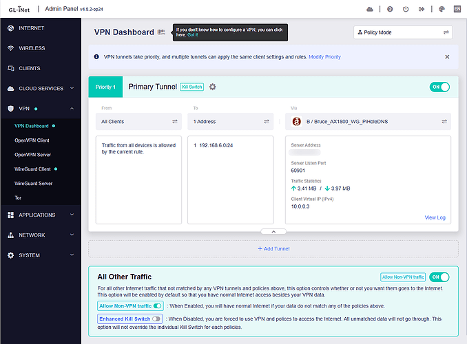

  • When tunnel policy To is 192.168.6.0/24 (VPN server router LAN subnet), the DNS resolution from Pi-Hole does not work:
Server:  UnKnown
*** Request to UnKnown timed-out
Server:  UnKnown
Address:  10.0.0.1
# without specified DNS server, request server should be used the WAN.
          121.14.77.201
Aliases:  www.qq.com

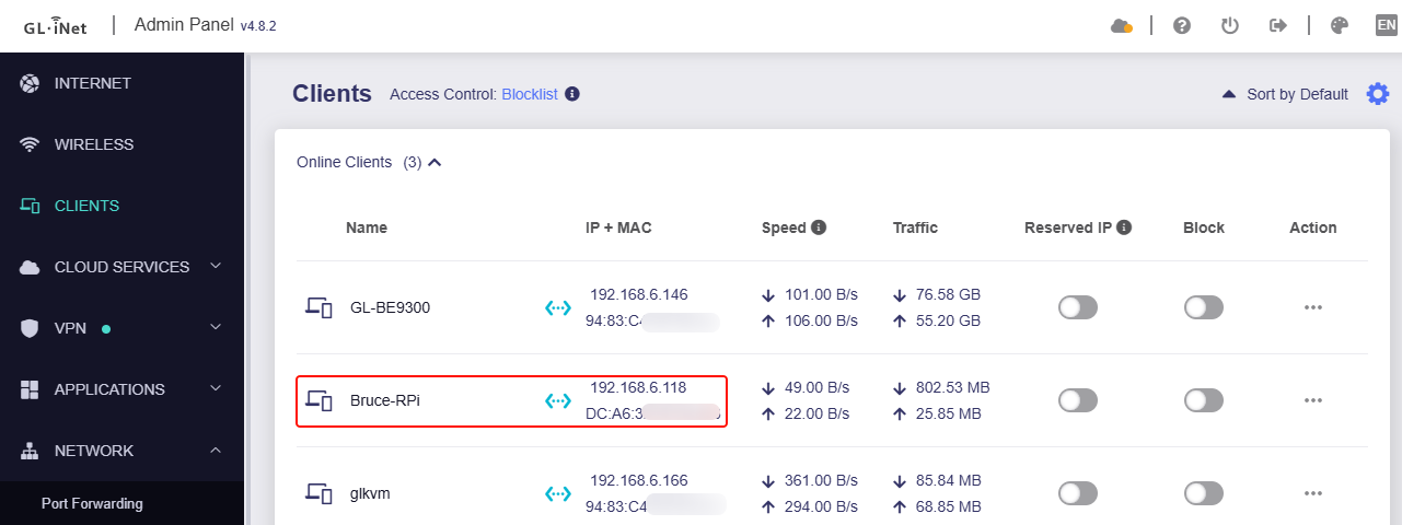

Whether To is All target or 192.168.6.0/24, PC ping [pihole LAN IP] is reachable:
C:\Users\itwuh>ping 192.168.6.118
Pinging 192.168.6.118 with 32 bytes of data:
Reply from 192.168.6.118: bytes=32 time=100ms TTL=62
Reply from 192.168.6.118: bytes=32 time=351ms TTL=62
Reply from 192.168.6.118: bytes=32 time=81ms TTL=62
Ping statistics for 192.168.6.118:
    Packets: Sent = 4, Received = 4, Lost = 0 (0% loss),
Approximate round trip times in milli-seconds:
    Minimum = 81ms, Maximum = 351ms, Average = 158ms

My test topology:
VPN server, AX1800:
VPN client, MT3000:

Update:
We re-check the VPN rules again:
The meaning of this rule is that the domain/IP of the resource that needs to be accessed will only go to this VPN server/node, and DNS resolution does not belong to the "resource to be accessed".
Based on your description, I assume that you should want to access certain custom domain which goes to the subnet "10.10.10.0/24":
Please copy the custom domain list from the pihole and paste to the router VPN client tunnel rule "To", that make specific part go to the VPN tunnel.
