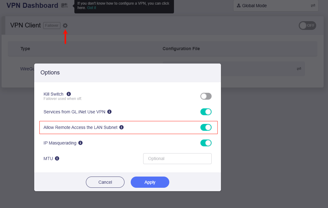

Keep this static route on the ASUS router:
Check if the VPN client on the AXT1800 enabled the option Allow Remote Access the LAN Subnet enabled?
If no luck, please share some screenshoots of your AXT1800 VPN client's configuration.
