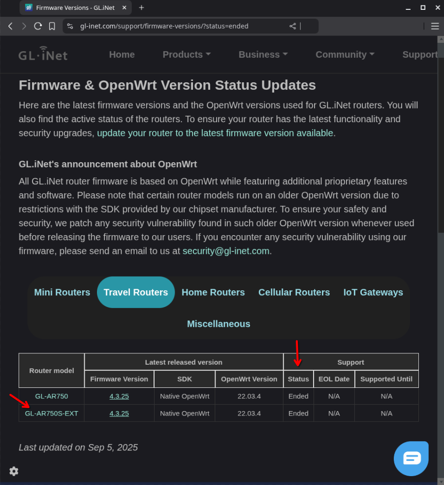

It is resolved. You just don't like the answer. Domains beyond the limited options as found in GL.iNet's DDNS, DOH, DOT, DNS:53 service(s) & features are not supported by that firmware including via rebinding. Your Slate (GL-AR750-EXT) is fully support by mainline OWRT. If you want the capabilities you're demanding flash the latest release or use the methods above as described within the limitations of the GL.iNet firmware.
I will also point out the Slate (GL-AR750-EXT) is EOL. There is no more support.

Q: when was it EOL’ed?
I think it was the beginning of this year.
Because the hardware performance is indeed a bit behind.
