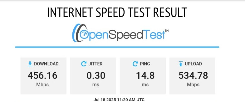

  3. Use the openspeedtest tool to test the network speed on the main router.
    https://openspeedtest.com/
thanks for answering, the test were done after each other at the same time, both routers connected via ethernet to main router which is ubuquiti gateway ultra.
  1. nothing extra, just basic setup on both gl-inet routers. hw acceleration is enabled on slate7, tested with disabled as well.
  2. it is slate 7 and slate ax, not MT3000.
    running speedtest app from galaxy 25 ultra connected to slate 7 vs slateax:
    slate 7: 470 down / 490 up
    slateax: 464 down / 397 up

  1. Unify internal speedtest show close to 500 up and down. as is openspeedtest.
reun iperf3 test on my s25 ultra via termux gets much better speed for slate 7, maybe iperf3 is single core and overloads slate7 cpu?
