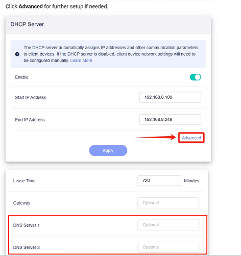

You can modify the DHCP configuration of the Guest Network to distribute different DNS servers.
Of course, please note that this will not take effect if the client uses encrypted DNS or a custom one.
Please refer to: Guest Network - GL.iNet Router Docs 4
Are you comfortable using openwrt command line?
No i am not sorry.
That manual / guide didn’t show any options about the guest network just the normal LAN / DHCP unless I have missed something.

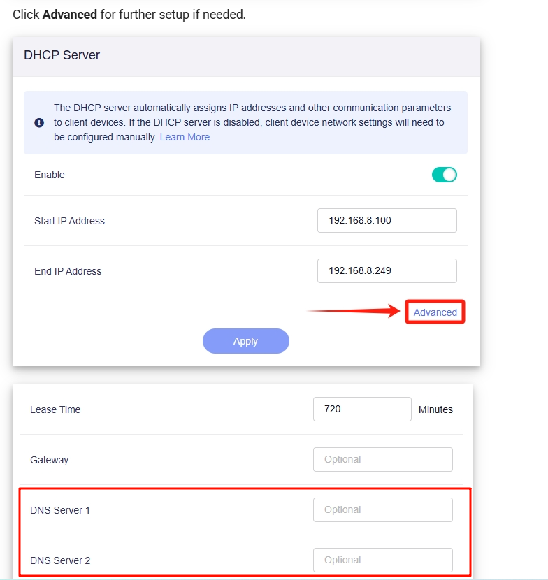

Oh, I think this statement might not be prominent enough.
Other basic settings and the DHCP server settings are the same as LAN.
The DNS settings distributed by DHCP are here:
Based on this, this doesn’t appear to offer different DNS settings for the guest network.
