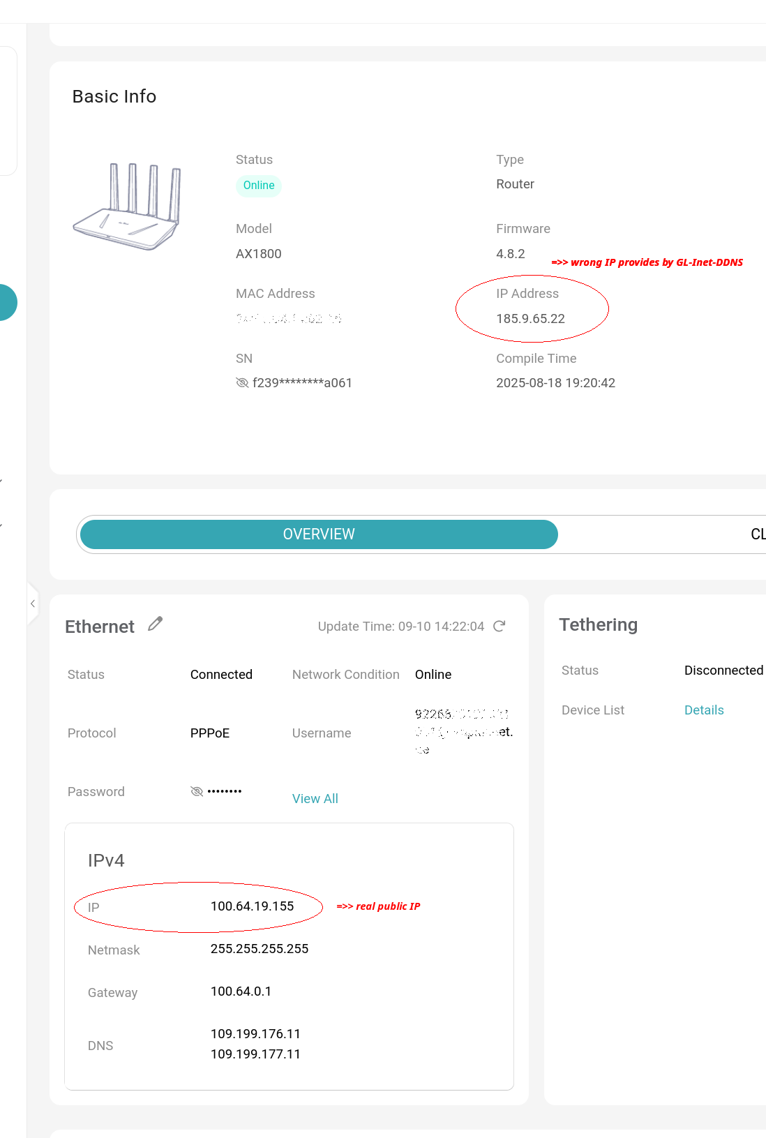

I’m running two AX1800 (Firmware 4.7.0) using VPN from outside with resolving via GL-Inet DDNS their hostname glxxxx.xxxx.com.
Nothing changes, nothing configured, but: Some days ago this resolving breaks. There is a different IP-value between provider IPO and router ip. Routers have a public IP that works (!) from outside (no NAT), but DDNS gives a wrong IP.
I did an upgrade from 4.7.0 to (beta) 4.8.2. as said in another thread. NO change.
Routers are actually not reachable via gnxxx.xxx.com hostname and e.g. VPN not usable.
… uuuups, be patient. After support calling: This seems to be an failure by my internet provider. I’m waiting for repairing their configuration. :zany_face:

My internet provider confirmed a configuration change to CGNAT, but it wasn't actually intended or planned. This error was corrected, and a public IP address was returned again.
