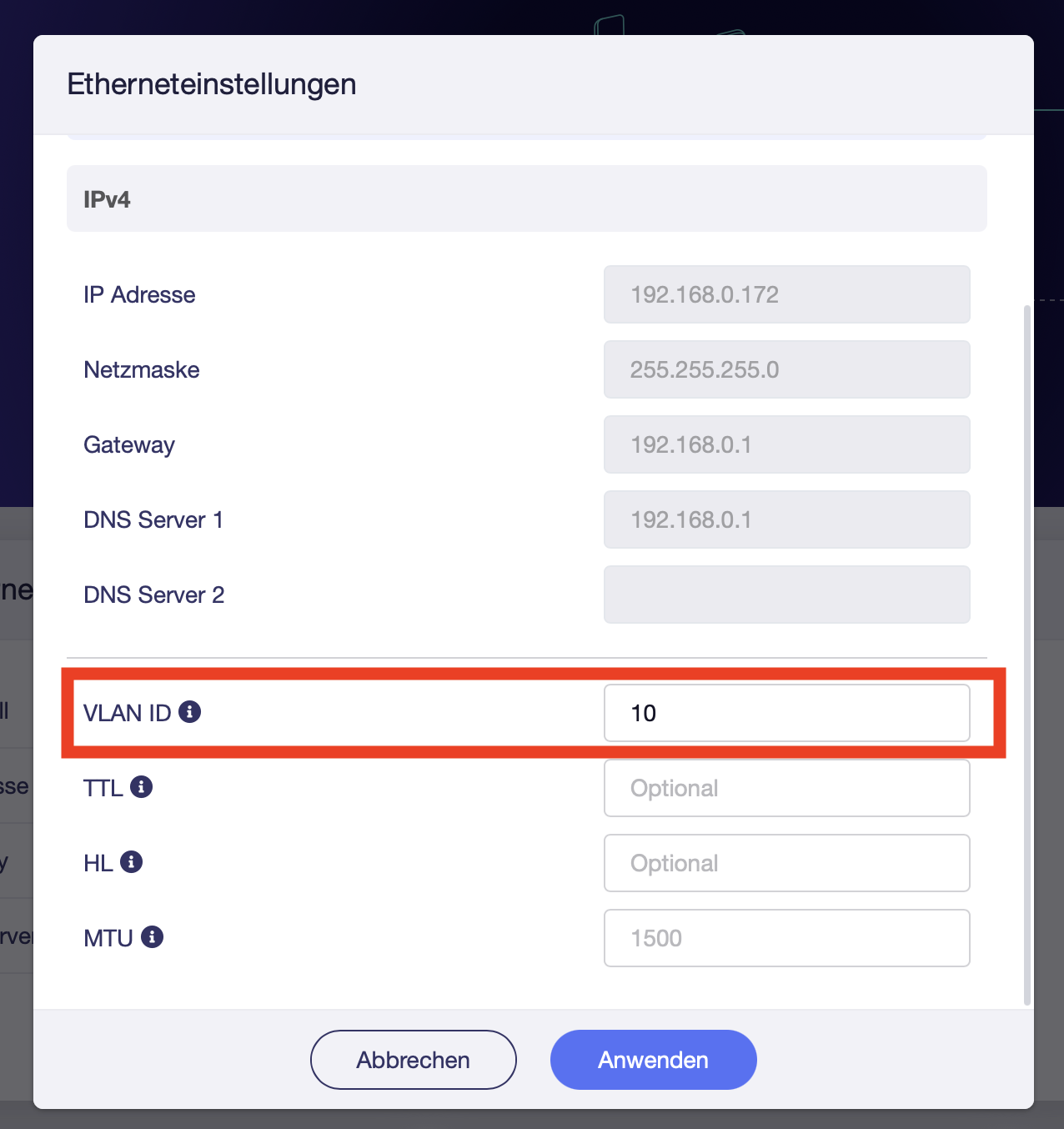

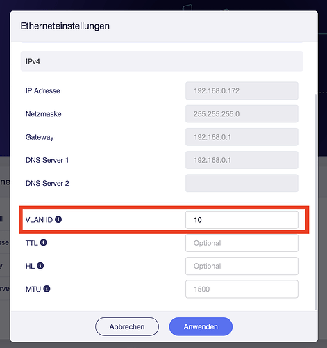

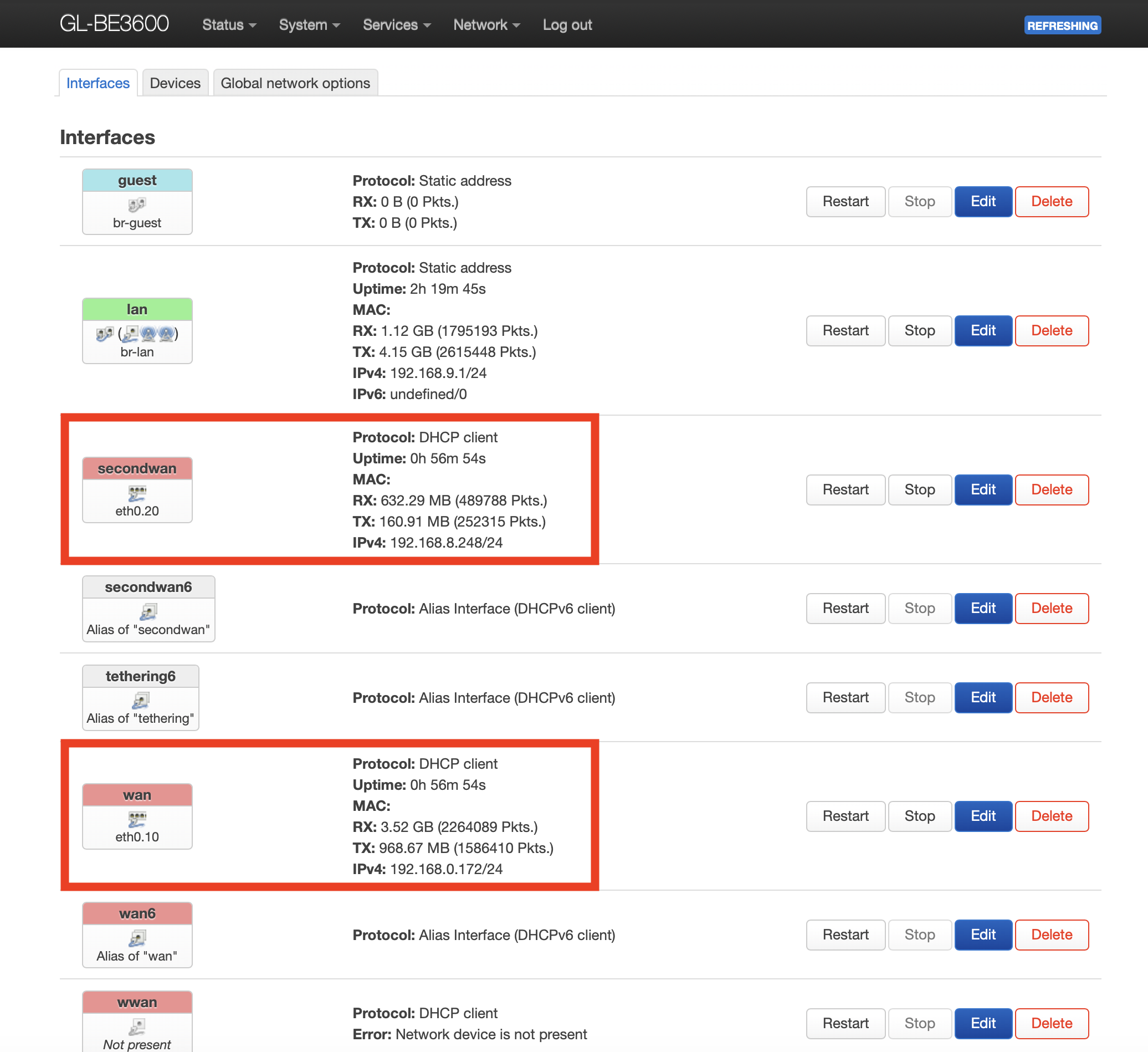

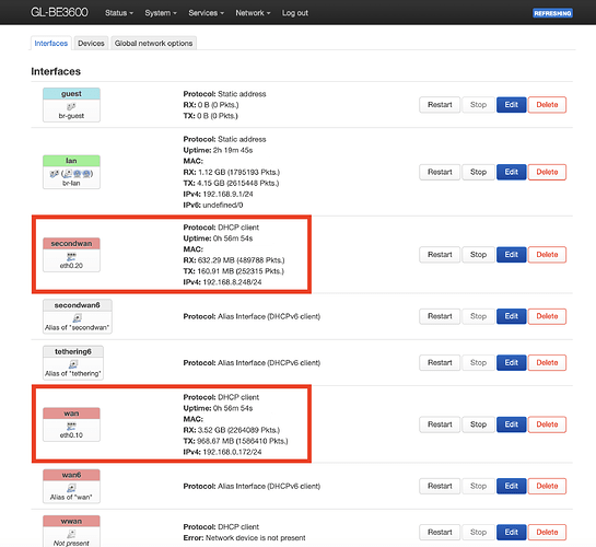

  • In LuCI I created two VLAN devices (eth0.10 and eth0.20) and assigned them to the existing interfaces “wan” and “secondwan”
  • Multi-WAN is configured in Load Balance mode (not Failover) with a ratio that prefers DSL
  • No additional slow 100 Mbit/s devices are connected; only one LAN port is used for testing (laptop directly connected via cable).

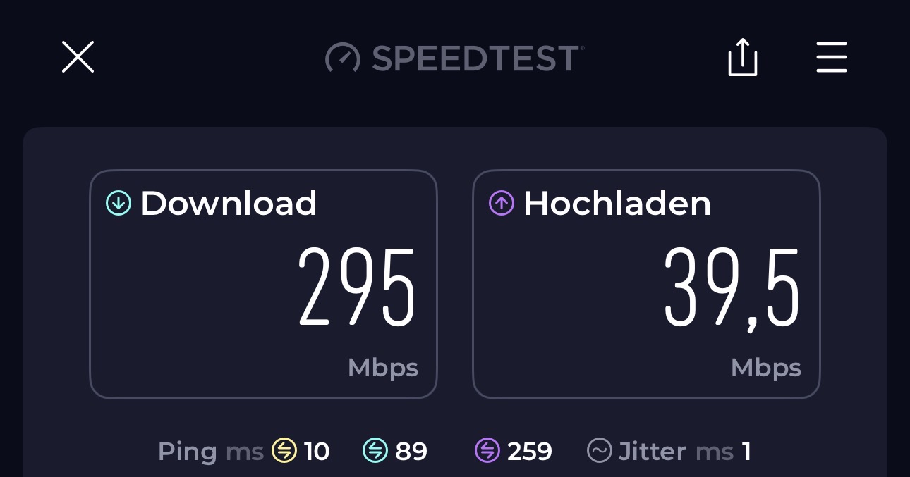

  • Download speed through the Slate 7 reaches nearly full DSL performance (~220–240 Mbit/s) only by LAN-port testing. On Wifi, the speed is throttled about 110 Mbit/s down.
  • Upload speed is massively throttled to ~3–12 Mbit/s (instead of the expected ~35–40 Mbit/s on DSL or ~20–40 Mbit/s on Starlink) by LAN-port testing. With WiFi testing, I've got full speed.
  • The same throttled upload behavior appears in both Load Balance and when forcing Failover to Starlink (DSL cable unplugged)
  • When bypassing the Slate 7 completely and connecting the laptop directly to the FritzBox LAN WLAN (DSL only), I get full symmetric performance (~220/37 Mbit/s). Same applies for my Starlink connection on GL-X2000. Both sources are running smoothly. Wired and wirelessly.

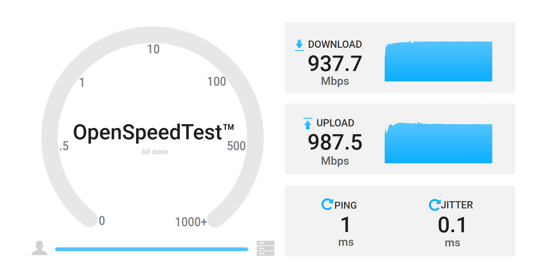

We attempted to reproduce a similar test locally using BE3600 v4.8.3, but were unable to replicate the issue.
Topology:
Speed test results (able to reach full speed on a single link):

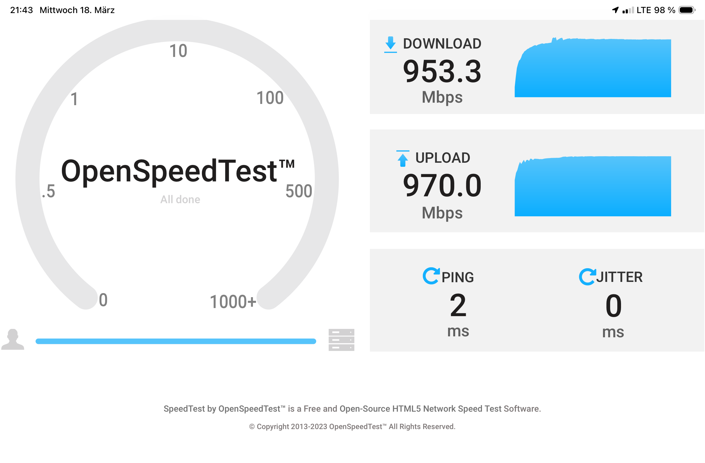

Local connections work like a charm. :rabbit::dashing_away:
It must be an issue with load balancing / multi-wan.
LAN speed
WiFi (5G) sitting next to the Slate 7
821 Mbit/s down
748 Mbit/s up
Peer 2 Peer tests with downloading some linux iso‘s via transmission, that the speed is around 150-250 Mbit/s.

  2. Regarding the OpenSpeedTest, could you clarify whether the server is deployed on the BE3600, or on an upstream router (as in our test setup)? Only the latter can accurately reflect whether performance remains normal after multi-WAN load balancing.
