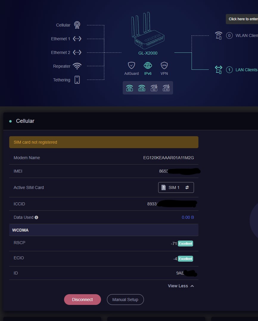

Hi, I bought Spitz Plus to replace my Cudy router that was unstable. But I cant get it to connect to 4G.
I'm using Free provider (France) sim card. I got this sim card as backup internet for my fiber connection from free. They use sim and IMEI pairing and it's delivered with "pocket" mini battery powered router with USB modem option. Unfortunately my current home router does not support USB modems - only ethernet as secondary WAN.
So on my previous router I cloned IMEI from this Pocket and it connected without any issues. Except connection was unstable, and I had to reset modem every day - which for backup WAN modem makes no sense at all.
I bout gl.iNet GL-X2000 as I know your routers (I own few, or rather I convinced my family to use them and I administer them). I have also 2 travel routers that I use (Slate 7 and Beryl AX). You may say I'm a fan and loyal customer ;-).
Happy with other products I pulled the trigger on Spitz Plus.
Problem is that it does not register sim card. I changed IMEI to same one as my "pocket" - as I did with Cudy where it worked.
On firmware version 4.7.13 If I'll choose IPV4&6 - no APN - everything else empty - it shows green dot - connected but sim card no registered and there is no data.

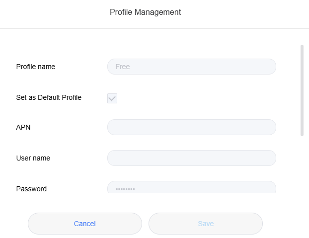

On firmware 4.8..2 (beta) - it does not connect at all and sim not registered message is there as well. But one thing that is weird on 4.8.2 is that when I leave APN field empty and I click SAVE. When I open sim card settings again - there is APN name ("free") back in. I erase it again - but it seems software put's it back again each time.

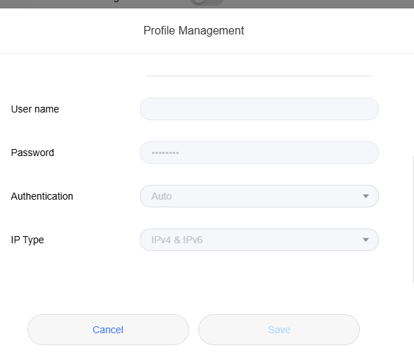

In original "pocket" router APN field was empty, Authentication was on Auto, and there is password with 8 signs - but when I inspect it in Chrome and change field to text - it's eight stars "********".
Also on Cudy router I did not use any authentication and it worked fine. Another thing on cudy - I could whatever APN in APN name => "free" or "Free mobile" - and it worked the same way - it connected with internet.
Hereis how it looks like in UI:
Provider’s router “pocket” has this config:
So like I said there is something in password - but I don’t think it’s real. After all Cudy router connects without issue without any password or authentication configured.
