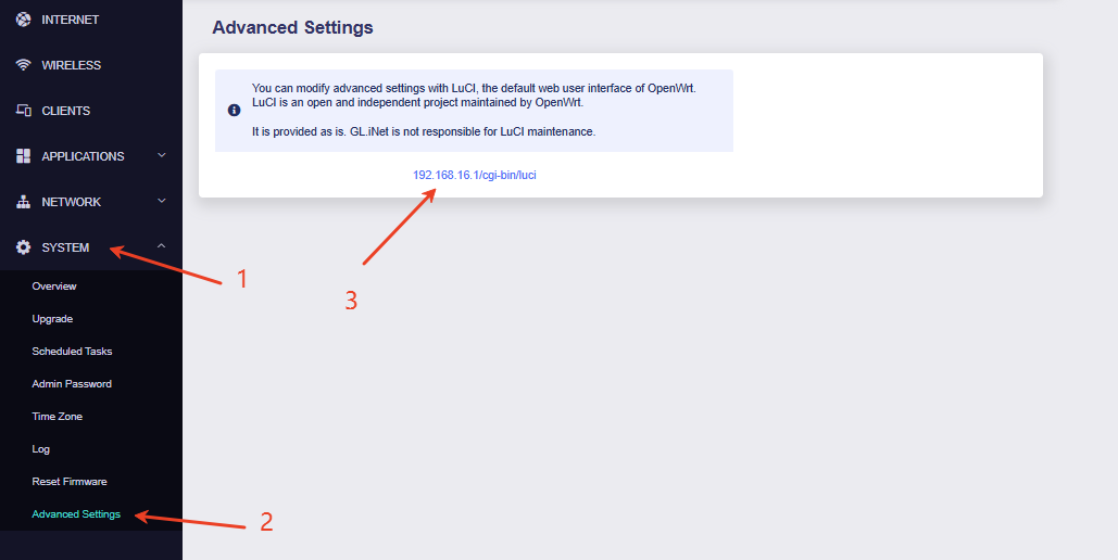

Go to LuCI: System > Advanced Settings

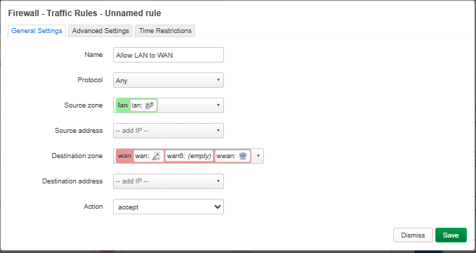

LuCI → Network → Firewall → Traffic Rules → Add
Configure the rule as follows:
  • Name: Allow LAN to WAN
  • Protocol: Any
  • Source zone: LAN
  • Destination zone: WAN
  • Action: Accept
Then click Save & Apply.
