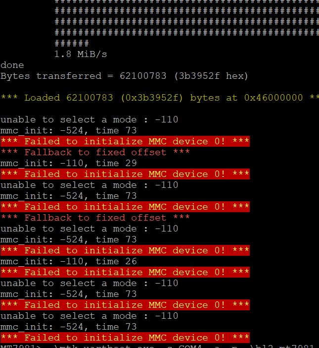

Having a bit of fun trying to revive my bricked Spitz :lying_face: :
The router seems to have a functioning Uboot (can get to 192.168.1.1), but flashing anything through the GUI fails.
So. had a go at the UART serial route…… tried to load and flash the firmware via tftp - firmware uploaded fine but the flash failed (see screenshot).
To me it looks the like the (firmware) partition is corrupted - any suggestions? Can this partition be erased and re-written, formated…?
It seems the partition is corrupted.

Can this partition be formated / re-written?
