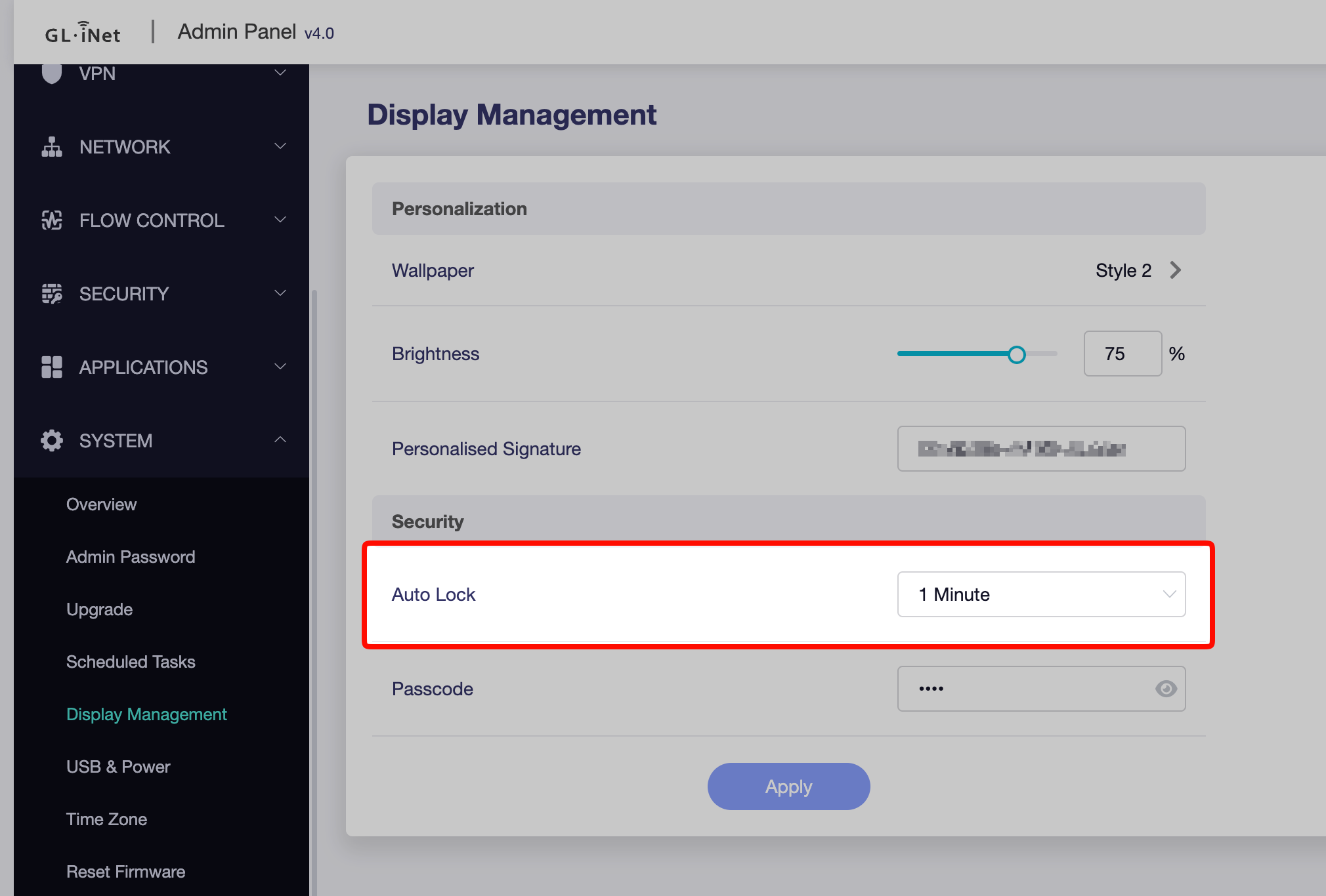

I quickly tested it on my Mudi 7:
The selected Auto Lock timeout controls the screen turnoff as well. So at least you can keep the screen turned on for at least 5 minutes so far.
However, you can overwrite these settings using SSH:
uci set gl_screen.generic.AUTO_LOCK_TIME='0'
uci commit gl_screen
/etc/init.d/gl_screen restart
0 seems to disable screen auto lock completely. But you can insert any lock time in seconds.
