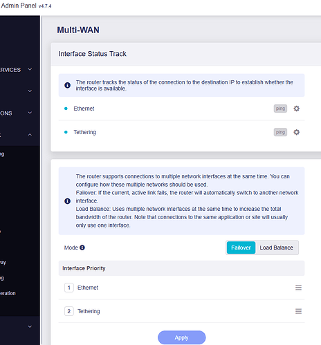

Running Brume 2 (v 4.7.4) as my main router. ISP connected to WAN port.

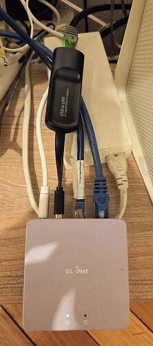

Multi-WAN failover: 4G modem connected via tethering using an RJ45 to USB via Brume 2 USB port.
If ISP fails, Brume 2 jumps to tethering. OK.

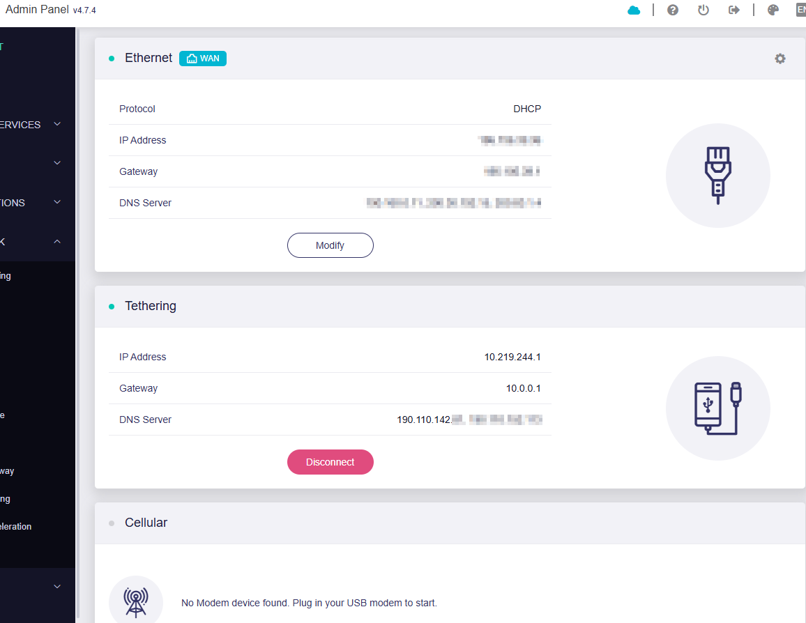

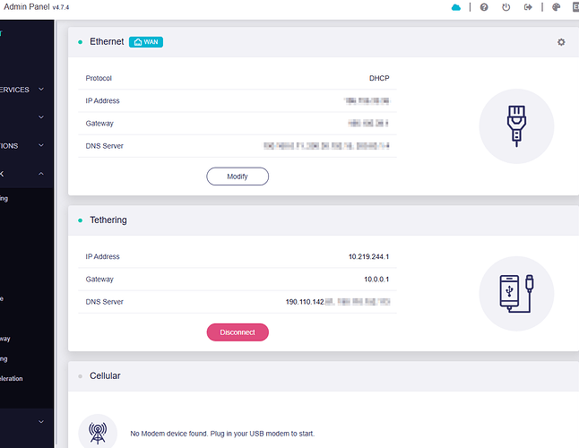

When ISP comes back up, the router doesn´t go back to ethernet unless manually turning off tethering.
I do have a Marble GL-B3000 which doesn't have this issue as a a LAN port is used (as WAN) as failover when ISP goes down. It does do automatic switching.
Setup:
Is there a way to disengage tethering when the ISP (WAN port) comes back up?
Thanks,
When Ethernet is restored and works stably for a period (the period depends on the sensitivity), it automatically switches back from tethering to Ethernet.
Multi-WAN - GL.iNet Router Docs 4

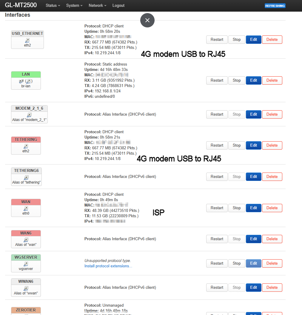

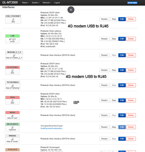

Did you manually create the USB modem interface in luci?
No, it was automatically created when I plugged in the USB-to-ethernet adapter
