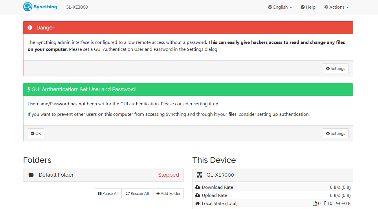

I got myself a Puli AX (GL-XE3000) and installed the latest firmware 4.8.3 for tailscale and syncthing. I have tailscale running and installed latest syncthing 1.18.2-1 through the plugin installer. Trying the web gui through 192.168.8.1:8384, but it cant be reached. Turned off adguard and tailscale, but to no avail. Do i need to do something through ssh?
As i understand in 4.8.3 syncthing should be working?
After installing syncthing, its default configuration is disabled and it only listens on the loopback address.
Therefore, you will need to SSH into the router and run some commands to modify some configuration:
# Install syncthing
opkg update && opkg install syncthing
# Modify the configuration
## Enable the service
uci set syncthing.syncthing.enabled='1'
## Change the listening address (adjust according to your LAN IP)
uci set syncthing.syncthing.gui_address='http://192.168.8.1:8384'
## Save the configuration
uci commit syncthing
# Start the service
/etc/init.d/syncthing start
After that, you should be able to access the Syncthing web interface at http://192.168.8.1:8384.
Thank you so much! I have been searching all over the net. I was about to quit. I followed your commands and after a reboot it worked!
Solved. Have a great day
