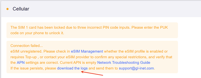

If there is option to export the log under the Cellular connection, please download it and share it with us for analysis.
