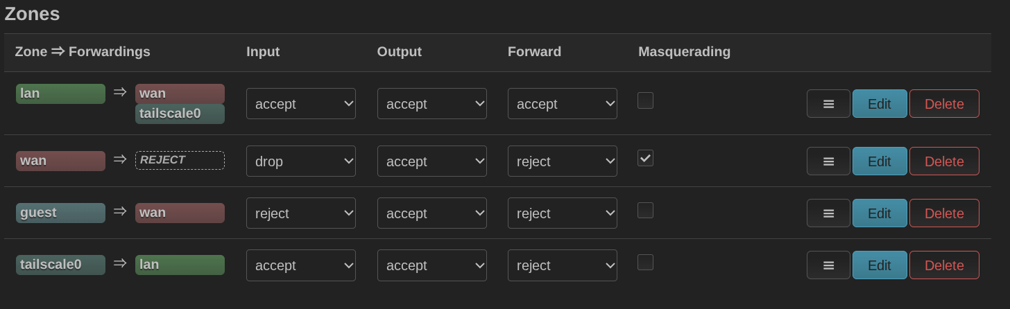

The tailscale interface has been added to the firewall in firmware v4.8.
Bruce_2025-09-29_18-31-59
Yeah… it doesn’t look like that in any of the three devices I have. Spitz AX 3000, Slate AXT 1800, Beryl AX 3000. All updated to the latest 4.8, and tailscale updated to the latest version. Except maybe the Spitz AX, I’ll have to double-check the firmware on that one.
I’m looking at updating the zones per this other post (a condensed version of steps mentioned earlier in this one). The firewall zone looks like that after following those steps, with the exception of the third column (forward) being set to ‘accept’ as well.
Forwarding "accept" is not necessary.

Not sure if I understand the question… I was looking for the same thing the OP was - why when I had TS enabled, with subnet routes turned on, a non-TS client couldn’t see/reach devices on the other end of the connection.
More specifically, before modifying the tailscale zone rules to include WAN, a smart TV (Roku) behind the glinet router couldn’t reach a media server in my home LAN, either by it’s LAN ip (192.168.1.x) or tailnet IP (100.x.x.x). Now it can.
