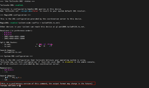

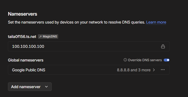

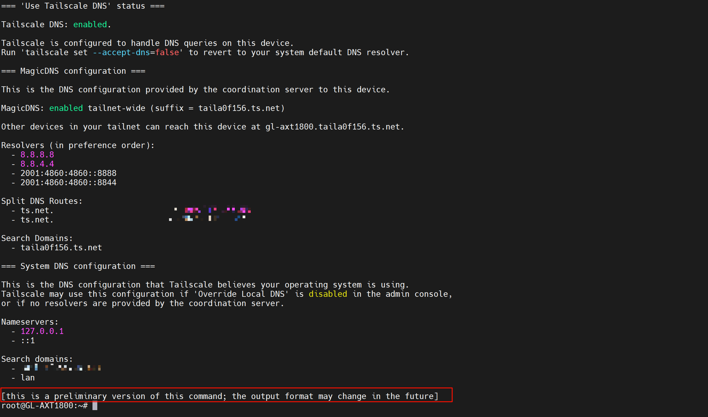

Currently, it seems that Tailscale CLI does not provide a stable interface for retrieving DNS configuration details from the Tailscale Admin Console.
For example, DNS settings configured in the Admin Console:
The Tailscale CLI does not return the related configuration information.
PixPin_2025-11-05_18-17-43
The only available output is a non-machine-readable, and it may change in future updates.
Therefore, the only possible solutions for now are to handle the custom DNS either manually or by modifying the script directly.
