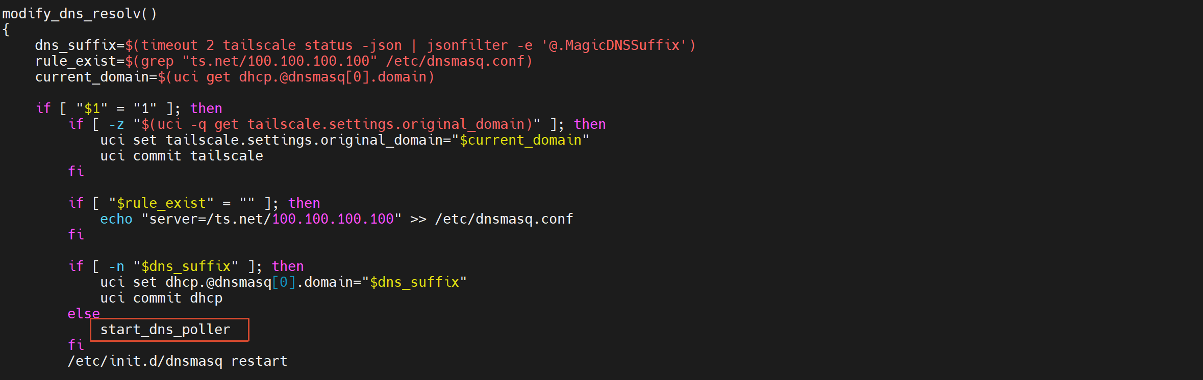

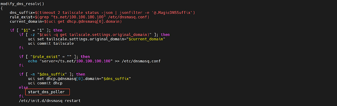

The Tailscale DNS daemon is created by the following section in /usr/bin/gl_tailscale.
Therefore, if you do not want it to modify dnsmasq's local domain name to the Tailnet DNS name, you can comment out the corresponding section.
