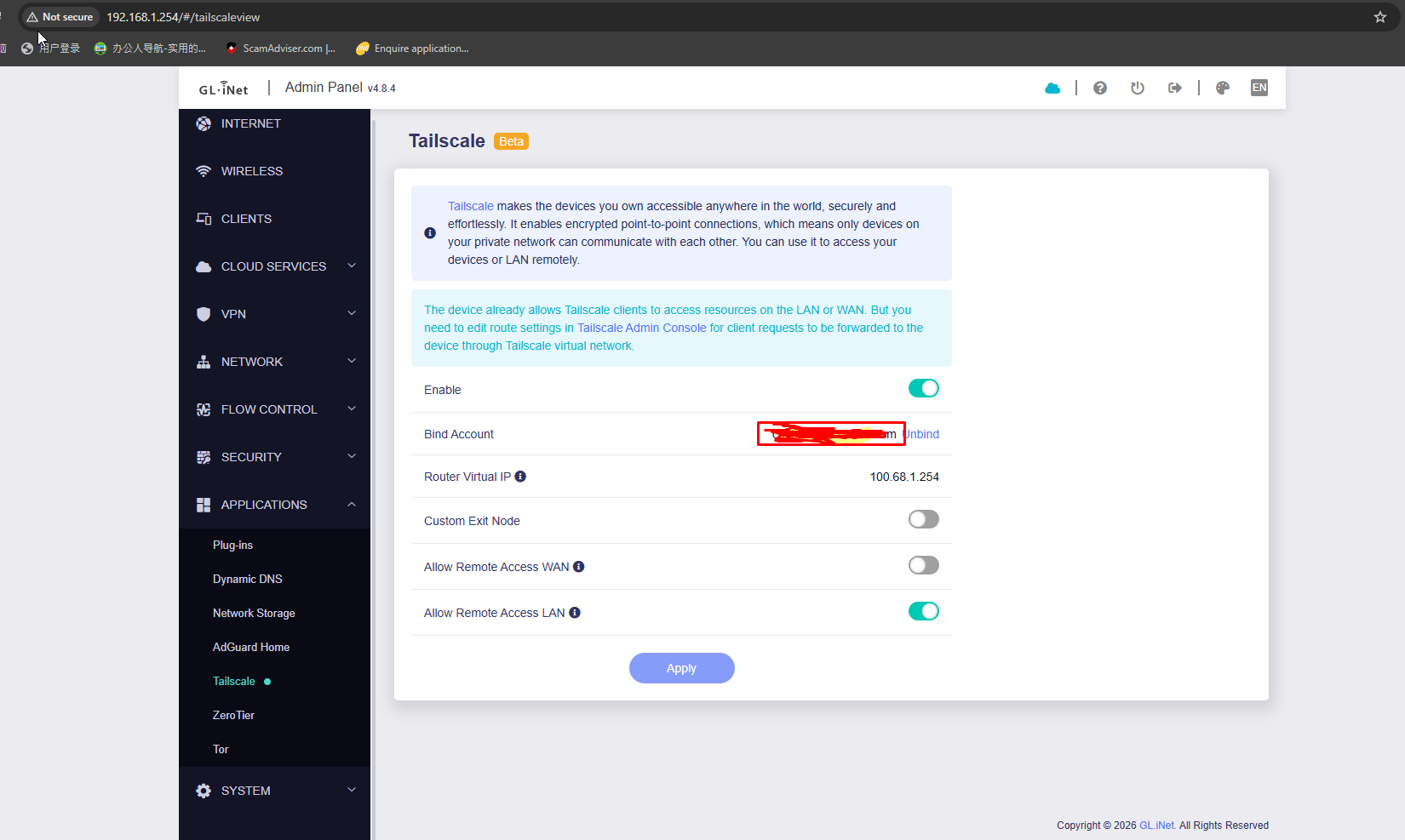

The main router and sub-router are GL.inet GL-AX1800.
I want to install Tailscale routers on the main router.

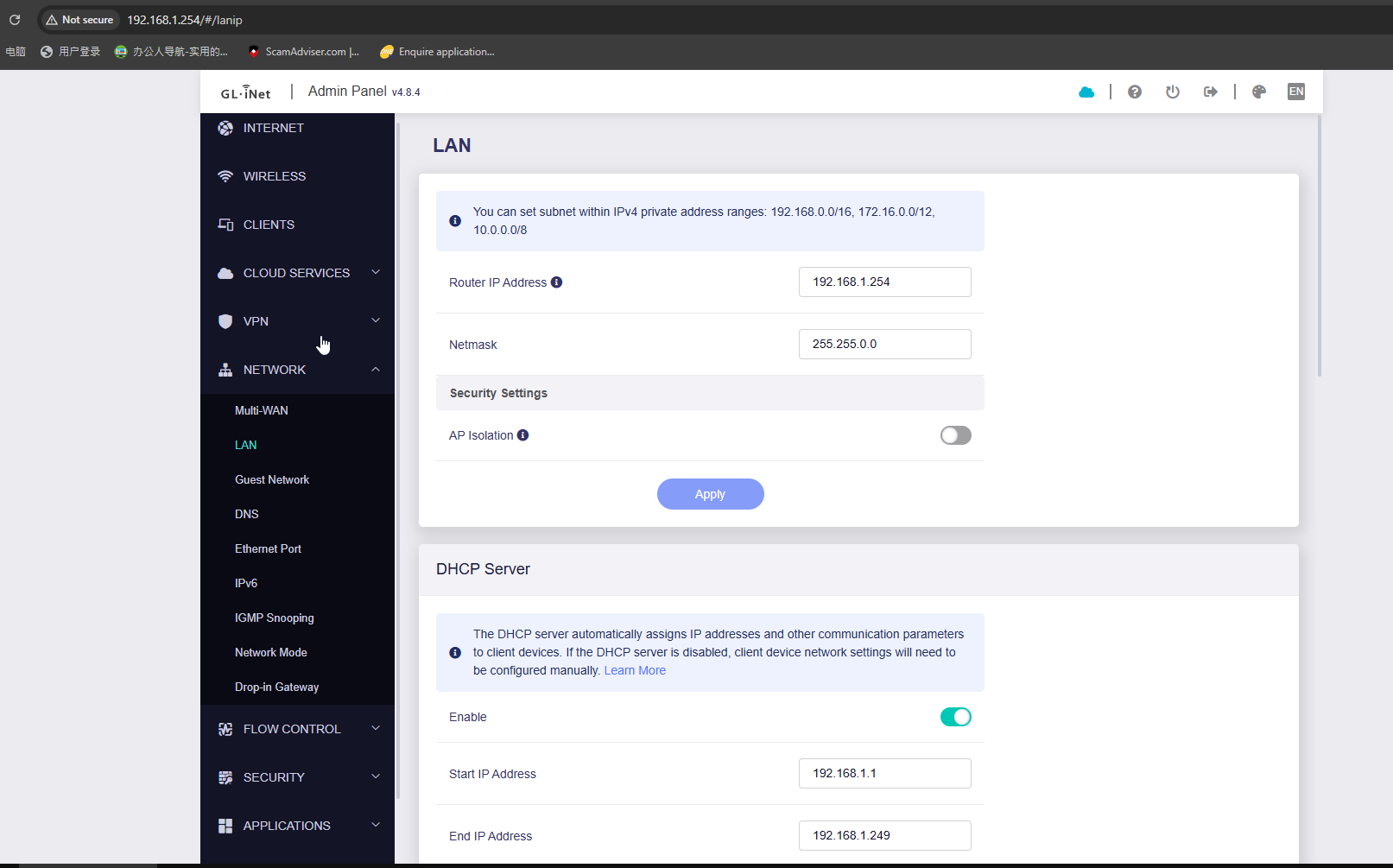

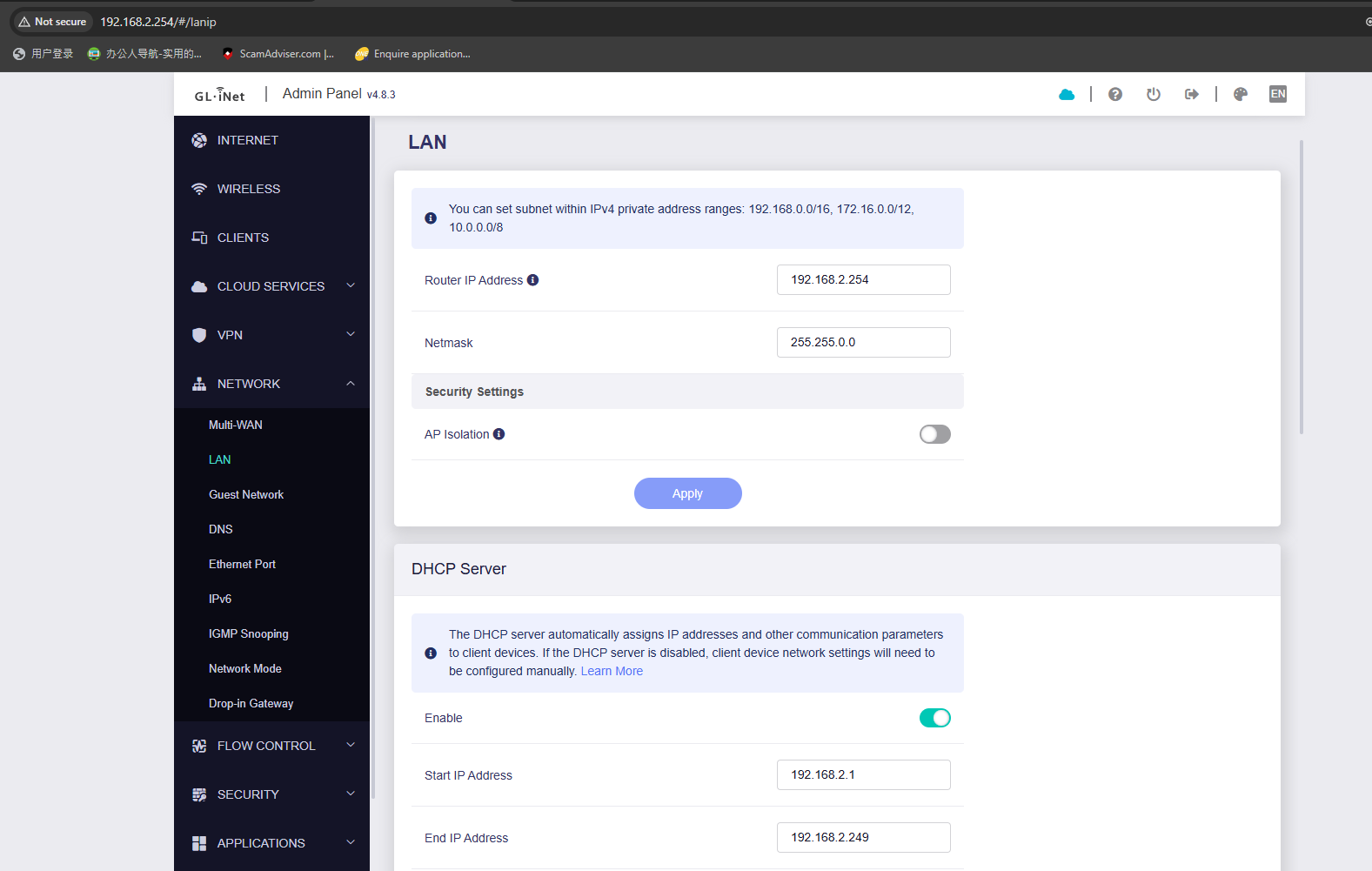

My main router settings are:
LAN IP: 192.168.1.254
Subnet mask: 255.255.0.0
DHCP Server: 192.168.1.1~249

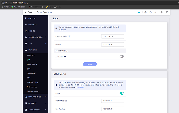

The sub-router settings are:
LAN IP: 192.168.2.254
Gateway: 192.168.1.254
DHCP Server: 192.168.2.1~249

Main Router Tailscale
Symptom:
enable Subnet Routing
External Network, cannot login 192.168.1.x
just can login 192.168.2.x only.
how to fix can login 192.168.1.x?

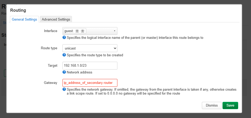

On the primary router, follow the guide below to advertise the secondary router's subnet in addition to the primary router's own subnet:
How to advertise the router's WAN parent subnet/route to Tailscale?
On the primary router, go to LuCI → Network → Static Routes and add a route to the secondary router's subnet.
After that, everything should work as expected, and remote Tailscale devices should be able to access both subnets behind the two routers.

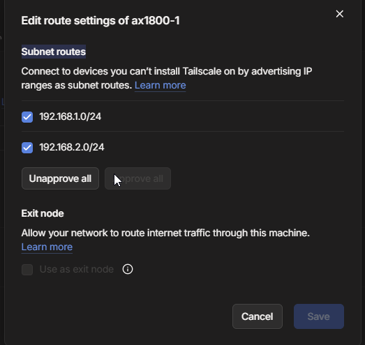

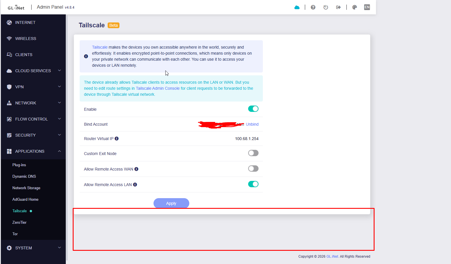

I think engineer, need design update firmware, refer my picture.
Put,
Advertise subnet routes
Update time frequest

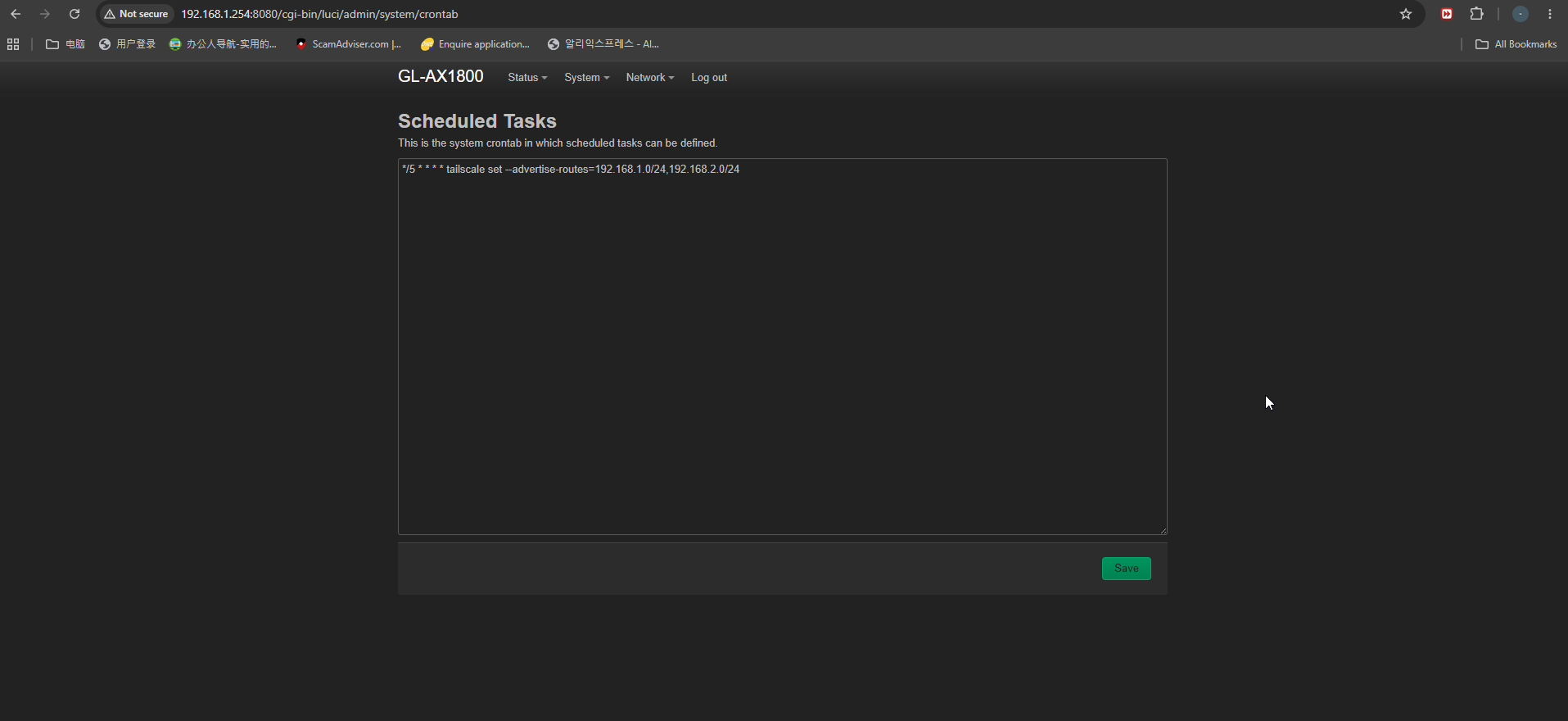

I found the solutions,
need externat network, to login back the internal,
Solutions as below,
Login LuCI> Systems > Scheduled Tasks, put the command,
*/5 * * * * tailscale set --advertise-routes=192.168.1.0/24,192.168.2.0/24
*/5 * * * *
mean: every 5 min, will updating Subnet routes.
