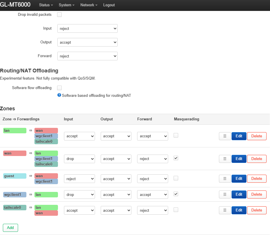

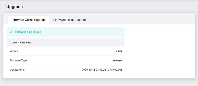

The tailscale firewall zone have been automatically added in the latest firmware of Flint3.

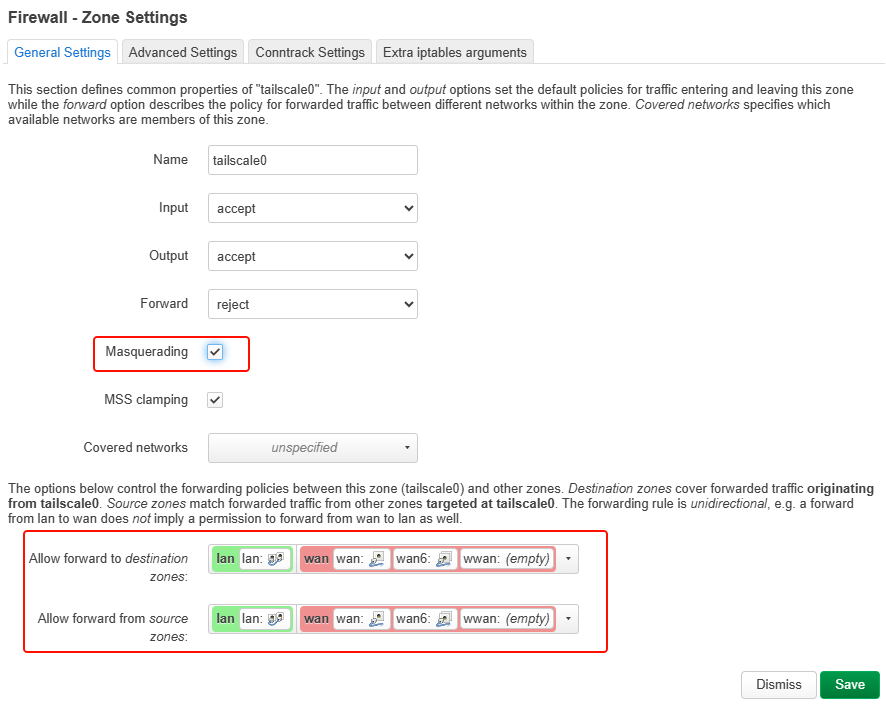

May I know what port forwarding rules to add? Do you mean the masquerade in tailscale zone?

Yup, exactly.

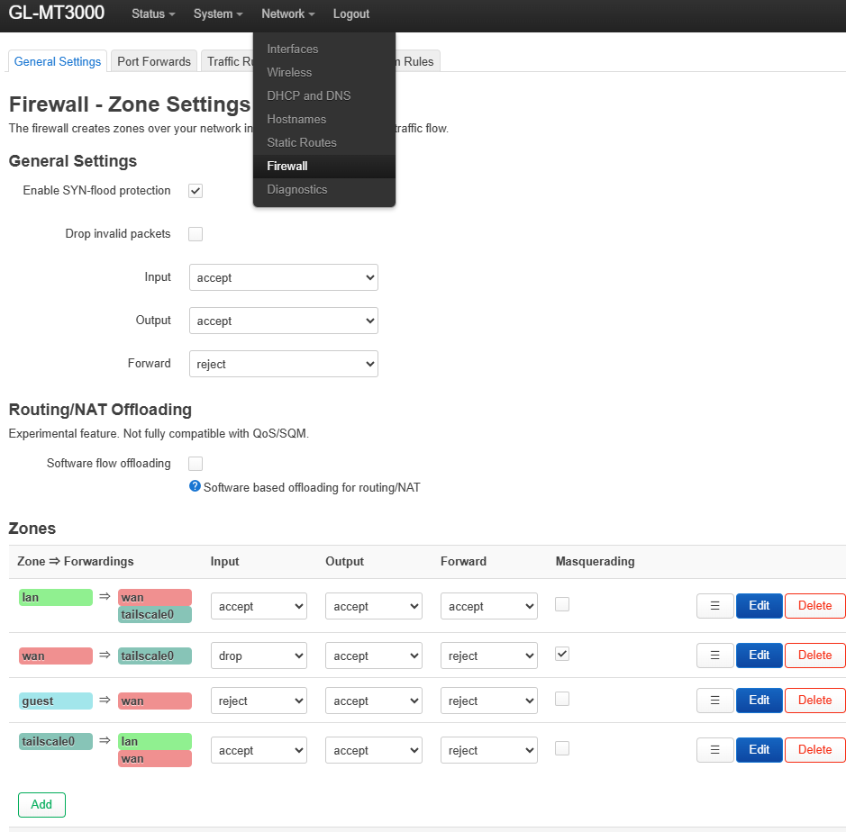

Will these updates be coming to the Flint 2, or just Flint 3 and later? I don’t see the dedicated tailscale zone on my flint 2 by default - just the interface.
