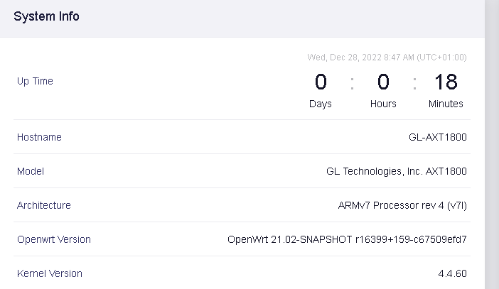

I just made the upgrade, and didn’t run into an error message:
The WireGuard client is a bit faster than before!
