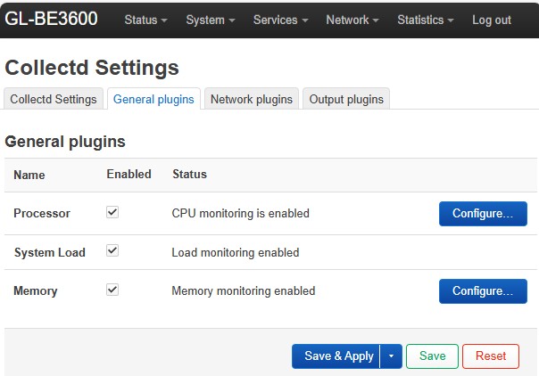

I'm trying to add thermal plugin support for collectd on my Slate 7 however opkg says the package doesn't exists. My search began when I noticed thermal wasn't an option in Luci(Stats-->Setup--> General Plugins and when I tried to install it from CLI i get an error

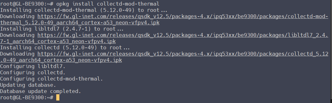

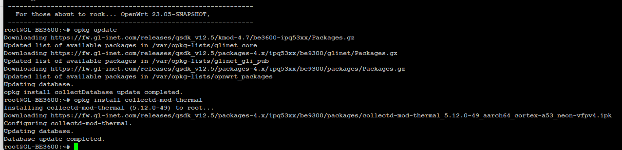

Please check again, have been added to BE3600 and BE9300 repo.
Installed and the thermal plugin showed up in Luci. The stats are sending to Grafana as expected.
Thank again Bruce.

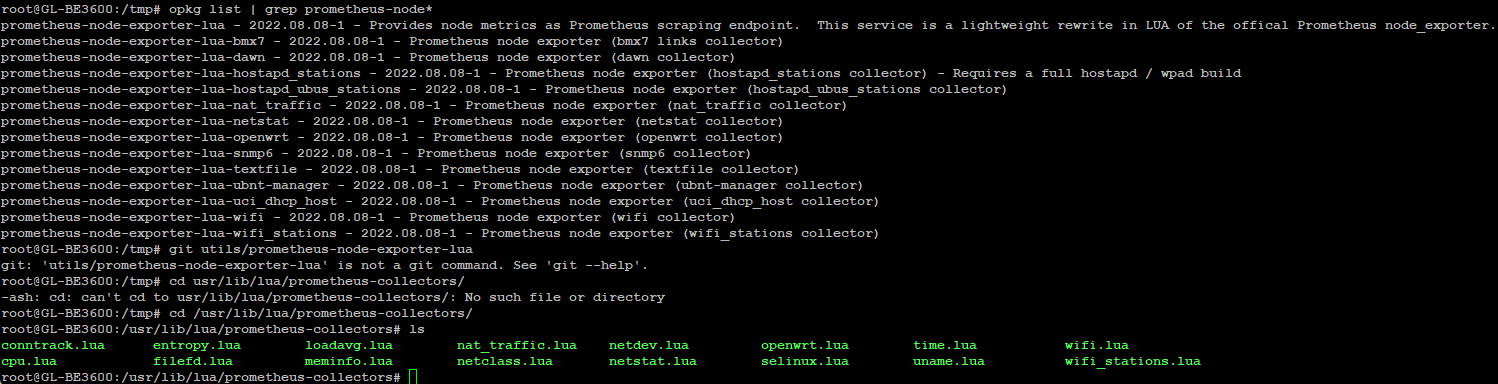

Looks like I spoke too soon. even after it's installed and rebooted the Prometheus-node-exporter-lua doesn't see the thermal zones to expose.
Shot in the dark, but do you happen to know why /how to get the thermal zones exposed to the
node_thermal_zone_temp is the metric missing.
oot@GL-BE3600:/tmp# opkg list | grep prometheus-node
prometheus-node-exporter-lua - 2022.08.08-1 - Provides node metrics as Prometheus scraping endpoint. This service is a lightweight rewrite in LUA of the offical Prometheus node_exporter.
prometheus-node-exporter-lua-bmx7 - 2022.08.08-1 - Prometheus node exporter (bmx7 links collector)
prometheus-node-exporter-lua-dawn - 2022.08.08-1 - Prometheus node exporter (dawn collector)
prometheus-node-exporter-lua-hostapd_stations - 2022.08.08-1 - Prometheus node exporter (hostapd_stations collector) - Requires a full hostapd / wpad build
prometheus-node-exporter-lua-hostapd_ubus_stations - 2022.08.08-1 - Prometheus node exporter (hostapd_ubus_stations collector)
prometheus-node-exporter-lua-nat_traffic - 2022.08.08-1 - Prometheus node exporter (nat_traffic collector)
prometheus-node-exporter-lua-netstat - 2022.08.08-1 - Prometheus node exporter (netstat collector)
prometheus-node-exporter-lua-openwrt - 2022.08.08-1 - Prometheus node exporter (openwrt collector)
prometheus-node-exporter-lua-snmp6 - 2022.08.08-1 - Prometheus node exporter (snmp6 collector)
prometheus-node-exporter-lua-textfile - 2022.08.08-1 - Prometheus node exporter (textfile collector)
prometheus-node-exporter-lua-ubnt-manager - 2022.08.08-1 - Prometheus node exporter (ubnt-manager collector)
prometheus-node-exporter-lua-uci_dhcp_host - 2022.08.08-1 - Prometheus node exporter (uci_dhcp_host collector)
prometheus-node-exporter-lua-wifi - 2022.08.08-1 - Prometheus node exporter (wifi collector)
prometheus-node-exporter-lua-wifi_stations - 2022.08.08-1 - Prometheus node exporter (wifi_stations collector)
root@GL-BE3600:/tmp#
Perhaps there is a prometheus-node-exporter-lua-thermal package which I am missing?

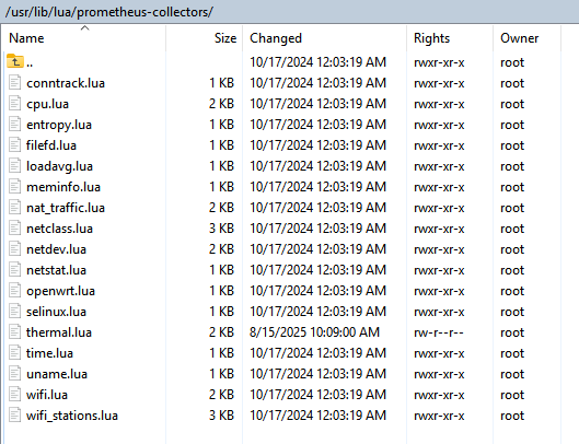

I've copied the missing .lua file into the collect directory
Then I restarted the node_exporter.....

In my case I used winscp to copy over the thermal.lua file from, github-utils/prometheus-node-exporter-lua/files/usr/lib/lua/prometheus-collectors to
dir on my be3600. no chmod +x nesssary it seems.
[restart node exporter service]
/etc/init.d/prometheus-node-exporter-lua restart
After that command the thermal zones start reporting and all is well. I hope that helps you idenify what package/file is missing or needs to be updated to include the thermal.lua file.
