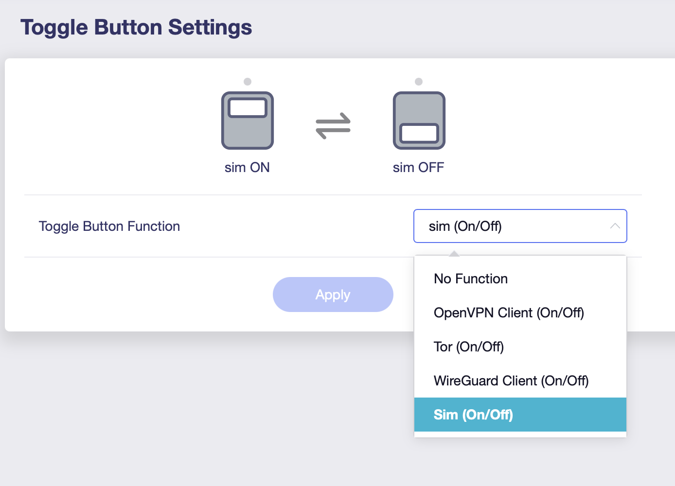

I am investigating how toggle button function pulldown menu text is determined on Mudi V2 with firmware 4.3.28.

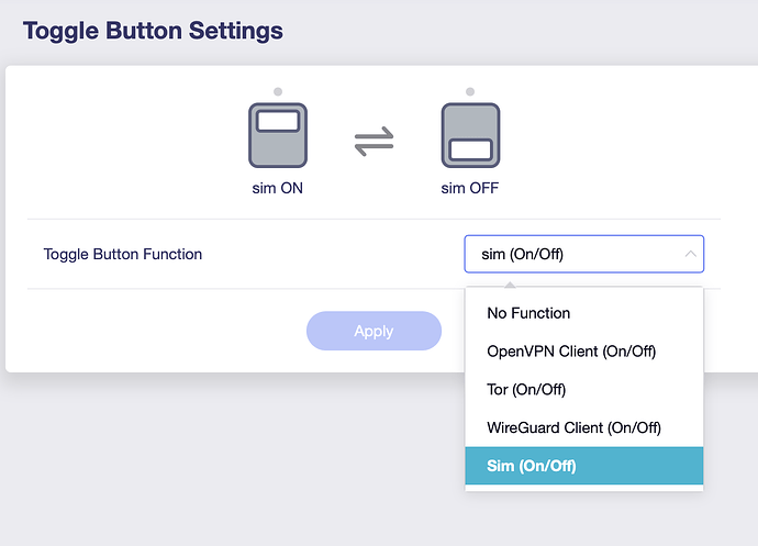

Specifically, this screenshot shows a customized menu option, sim (On, Off) and Sim (On, Off), that does not appear on the factory default pulldown menu.
What is the source file that includes the text parameter "sim (On, Off)"?
I know GL web interface is generally compressed .js but that text string "sim (On, Off)" is custom - and it doesn't appear magically.
My objective is to modify the text string "sim (On, Off)" with my own text, let's say "Bob (On, Off)", for example.

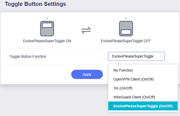

Go to /etc/gl-switch.d/ and there must be shell-file sim.sh
Rename it to something you want (for example EvolvePleaseSuperToggle)
As a result you will see:
Beautiful! Thank you.
