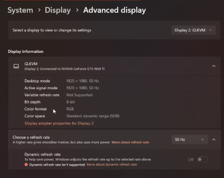

I’m having the exact same issue.
On my Windows 11 Asus G14 the machine keeps doing the “display connected” animation.
I’ve updated to the beta version and no change.
the only way that fixes temporary for me is going on the windows advanced display options and set the GLKVM to 50Hz, but if the machine sleeps or reboots, it will go back to the failed state.
it looks to me that the KVM maybe is not reporting correctly the supported refresh rate to windows.
