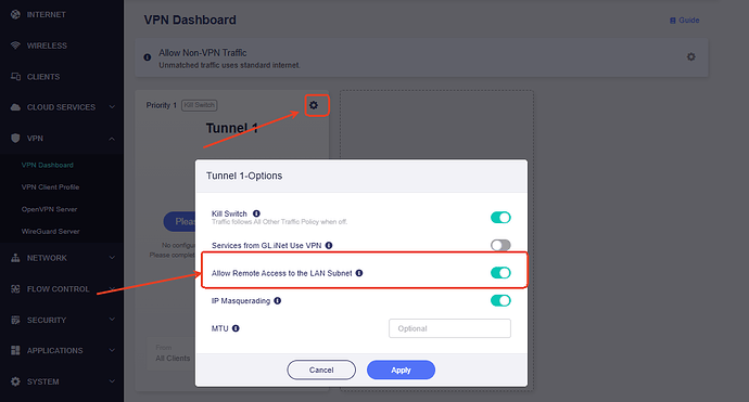

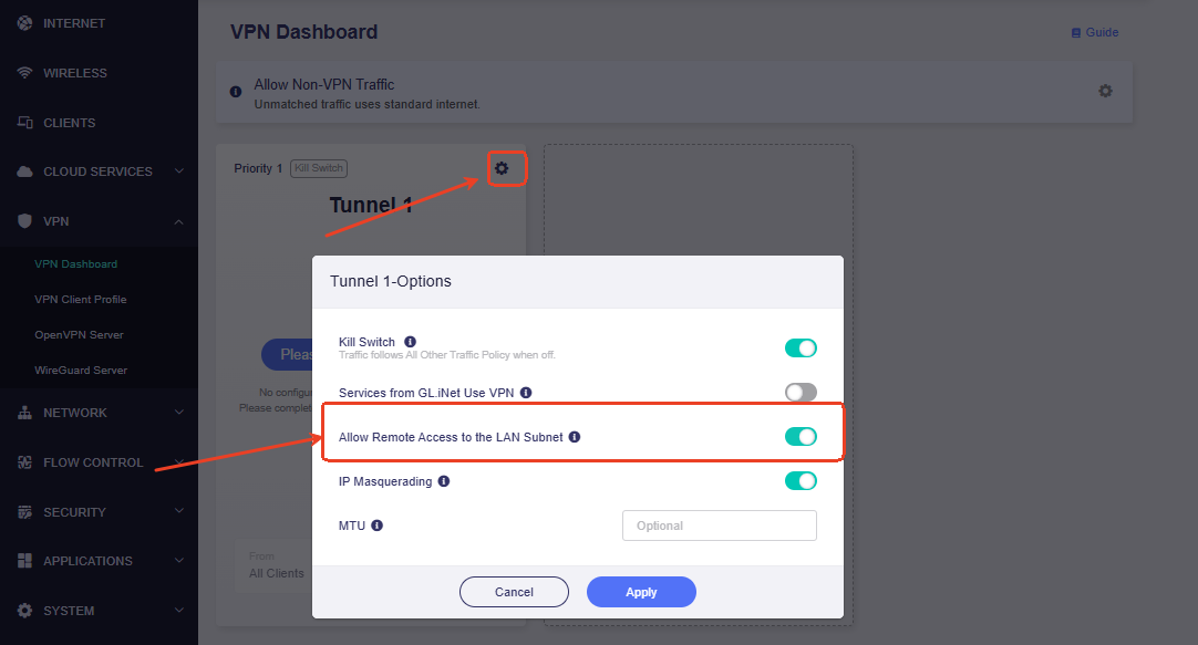

  1. Allow access to the LANs at Sites B and C
    On the WireGuard Client at both Sites B and C, enable Allow Remote Access to the LAN Subnet.

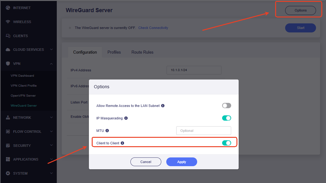

  2. On the WireGuard Server at Site A, open Options and enable Client to Client .

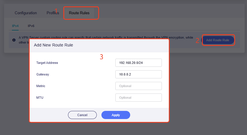

  3. Then add the following two Route Rules on the WireGuard Server.
Target Address: 192.168.20.0/24
Gateway:        10.0.0.2
Target Address: 192.168.30.0/24
Gateway:        10.0.0.3
