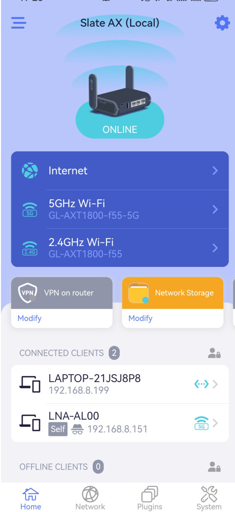

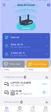

I tested it locally and everything works fine.

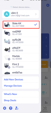

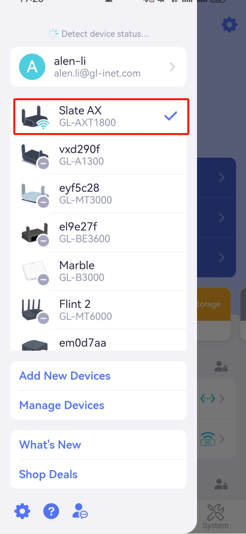

You can add a device on the APP, enter the IP address, and then manage it.
