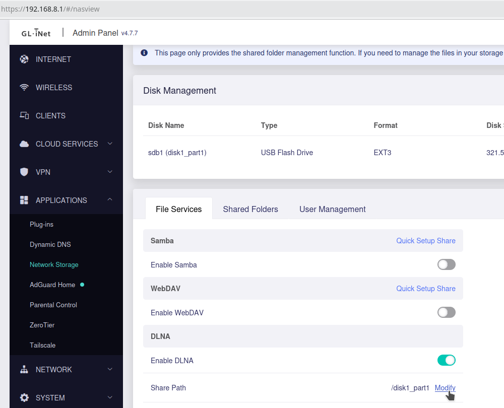

I can share a disk through the network storage functionality ( Network Storage - GL.iNet Router Docs 4 ) and I can access it just fine through sftp at sftp://root@192.168.x.y/tmp/mountd/disk1_part1/

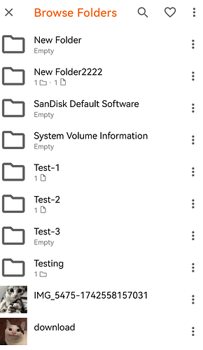

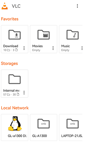

However, when connecting to the "GL-mt6000 DLNA Server" through VLC for example, only some of the folders are shown. If I "force" a rescan by changing the path shared, by sharing only a sub-folder for example, /disk1_part1/test/
then all of the test folder is correctly shown, and I can even revert to sharing only /disk1_part1/ and I will see all the folders.

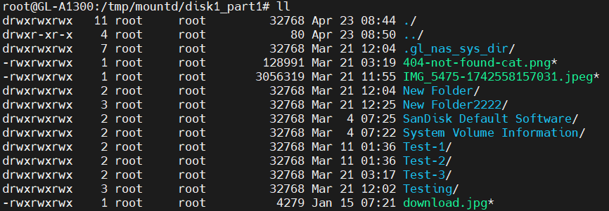

I used an A1300 router, V4.7.2, for testing and there was no problem. Does the problem have to be reproduced with an MT6000 device? Have you tried anything else?

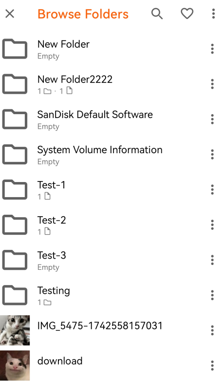

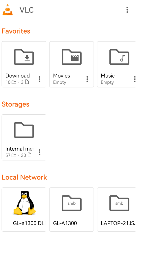

I tested again using MT6000 version 4.7.7, and was able to view all file contents on the mount point.
