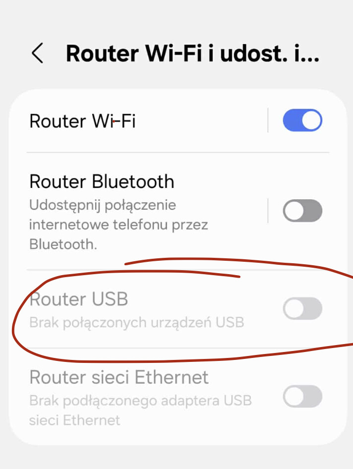

Usually when I want to get internet via my phone i would setup a hotspot and connect to it. Now i want to try USB tethering. The problem is that my router/phones (both android an iphone) do not see the connected E750:

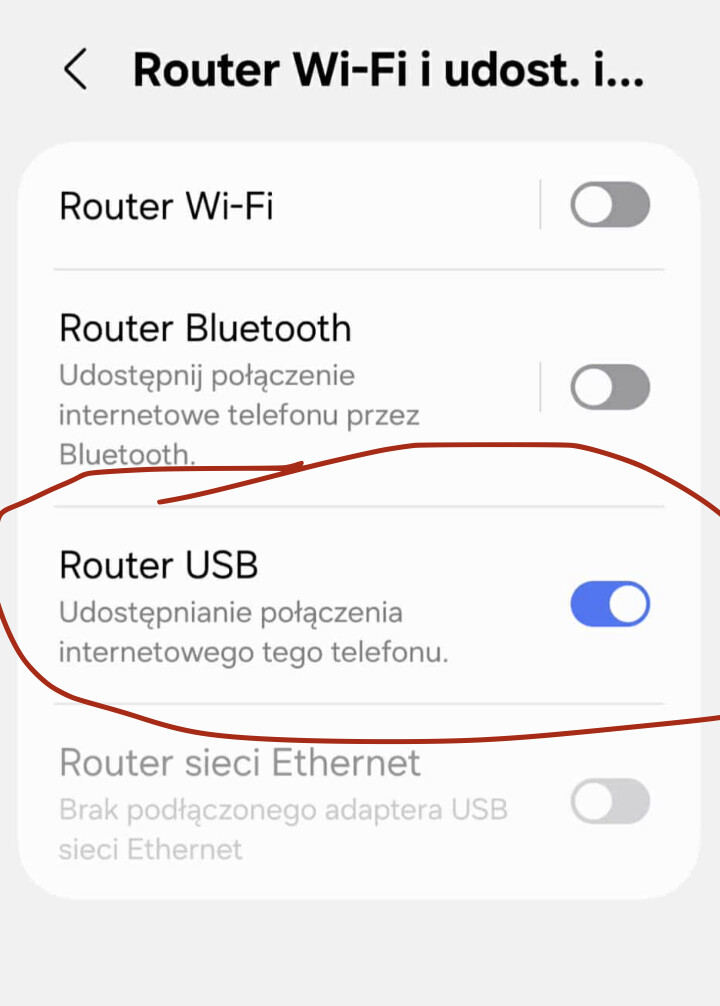

but i know that my phones/cables are working because i can tether to my macbook:
Is there anything missing in my configuration of E750? Is there something broken with the port?
