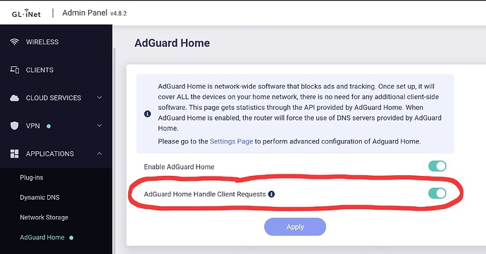

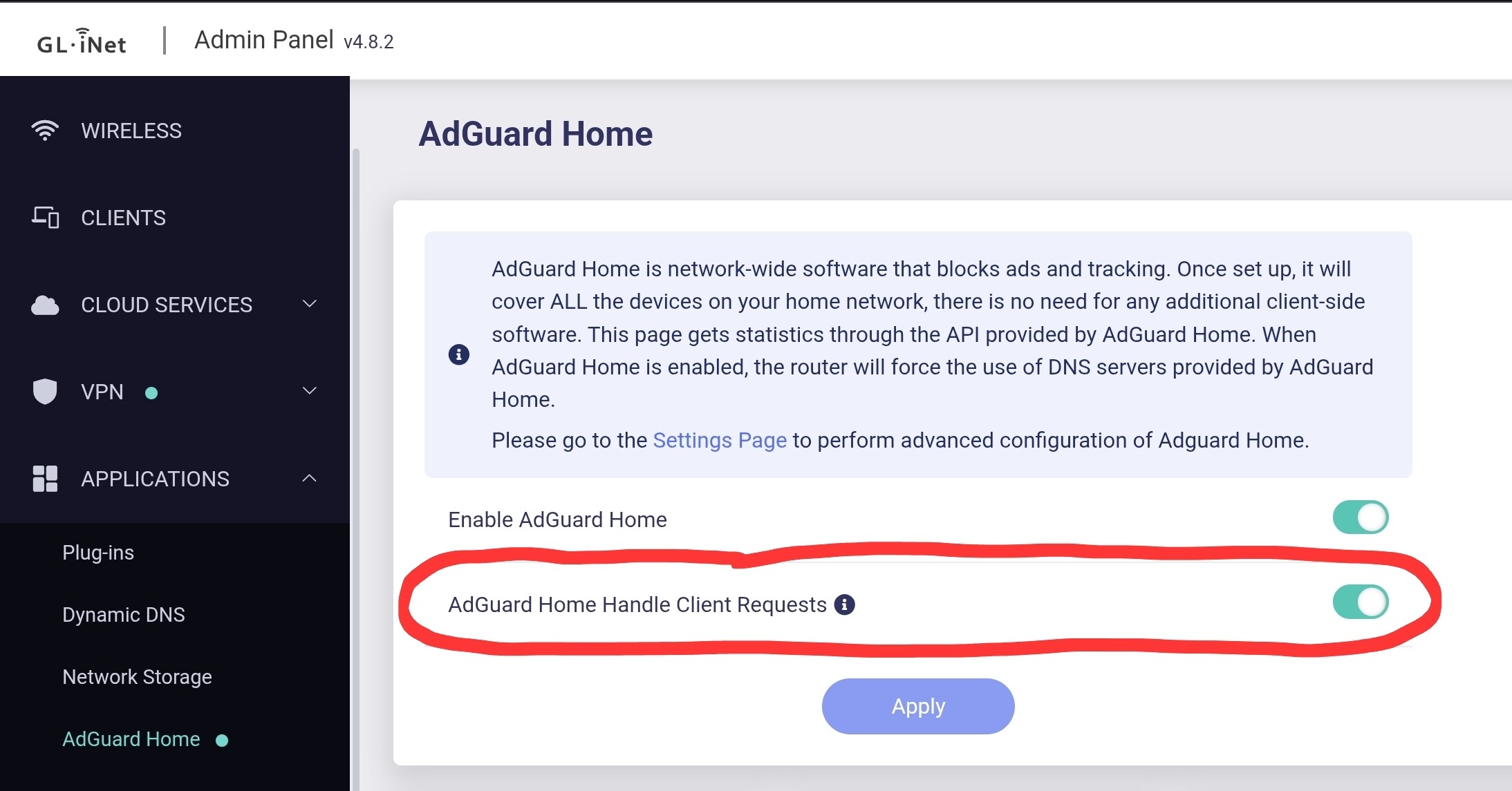

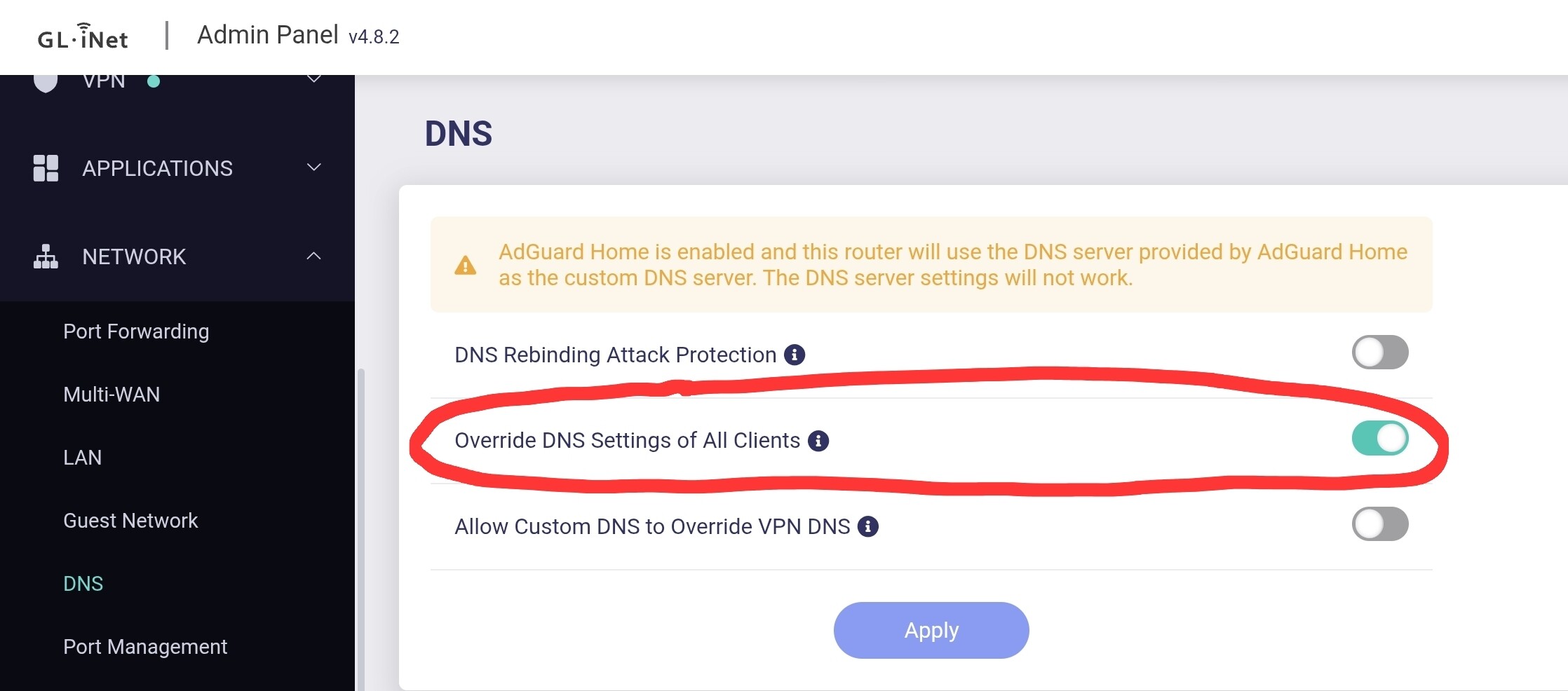

I'm running a WG Server on my Flint 3. I toggled the following options and my WG clients show in AGH query log. No changes in Luci.
