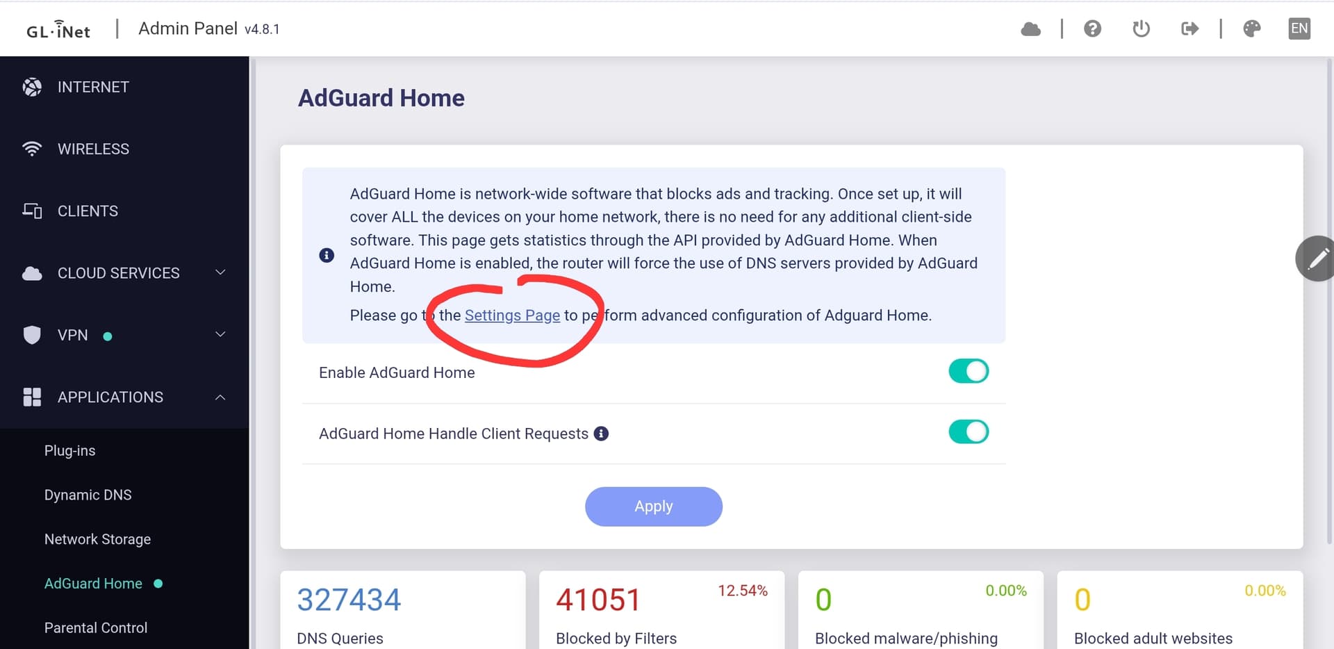

In this scenario you don't need Adguard Home. Just disable and and set ControlID's DNS as your DNS:

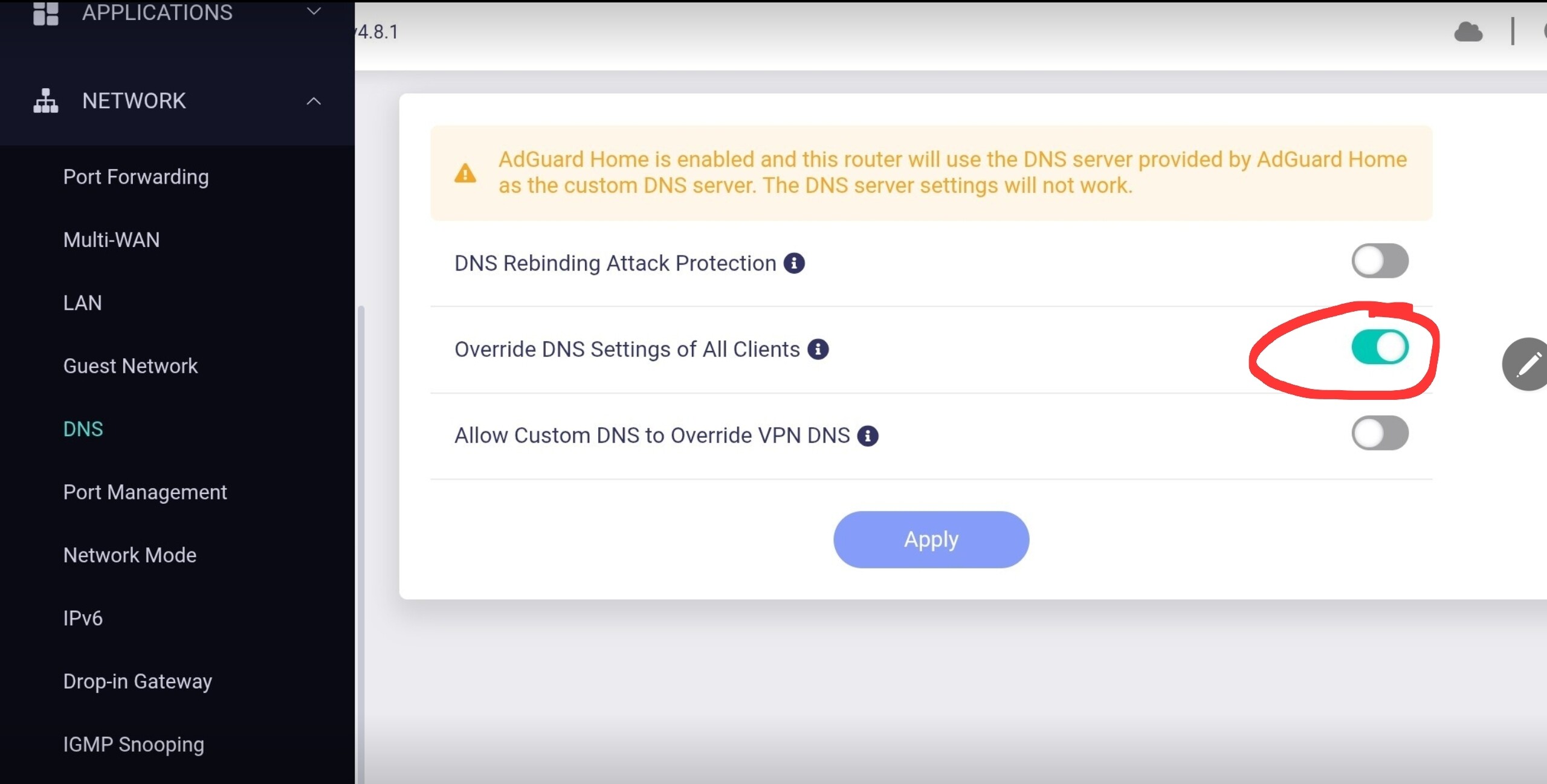

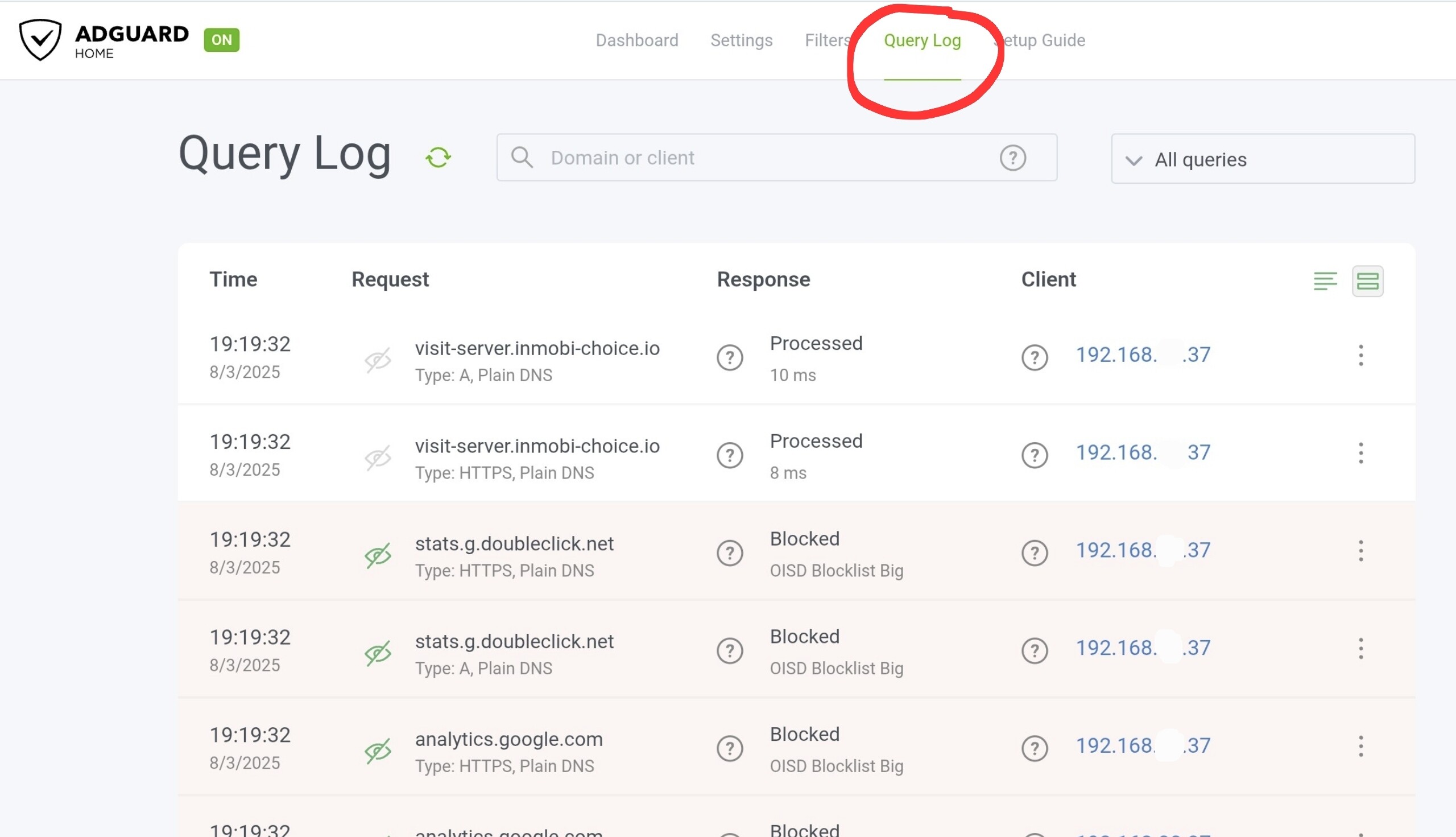

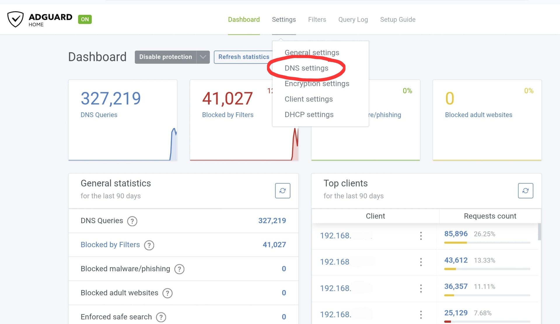

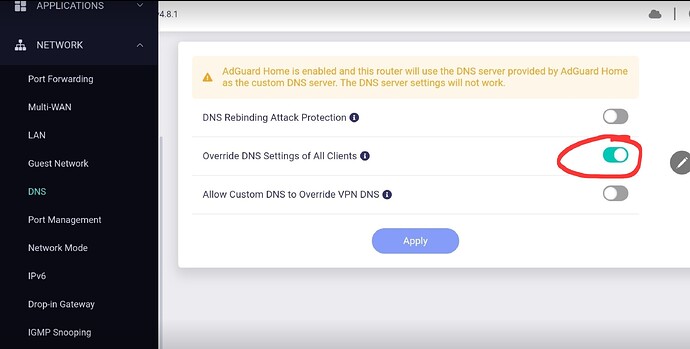

Enabling DNS in both places would cause conflicts. Go into the Adguard Home settings and add ContolD to the Upstream DNS Servers. The Query Log will tell you what's getting blocked and allows whitelisting if needed. Lastly, enable Override DNS for all clients.

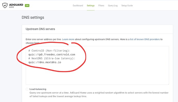

I have a paid subscription to ControlD. What exactly should I put into AGH's Upstream DNS Server? Currently, I have DoH settings like "https://dns.quad9.net/dns-query" and "https://dns.nextdns.io". I want to continue using DoH. I've been recommended to use these two. Do I have to delete them if I add ControlD to the list? If not, where should I add ControlD and in what order?
Why do you have DNS Rebinding Protection Off? I thought it was recommended to have that on.
In this case, shouldn't I also have allow custom DNS to override VPN DNS on?

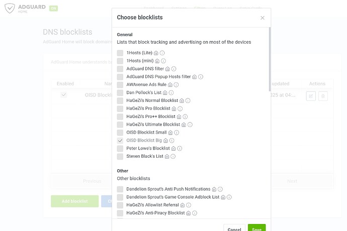

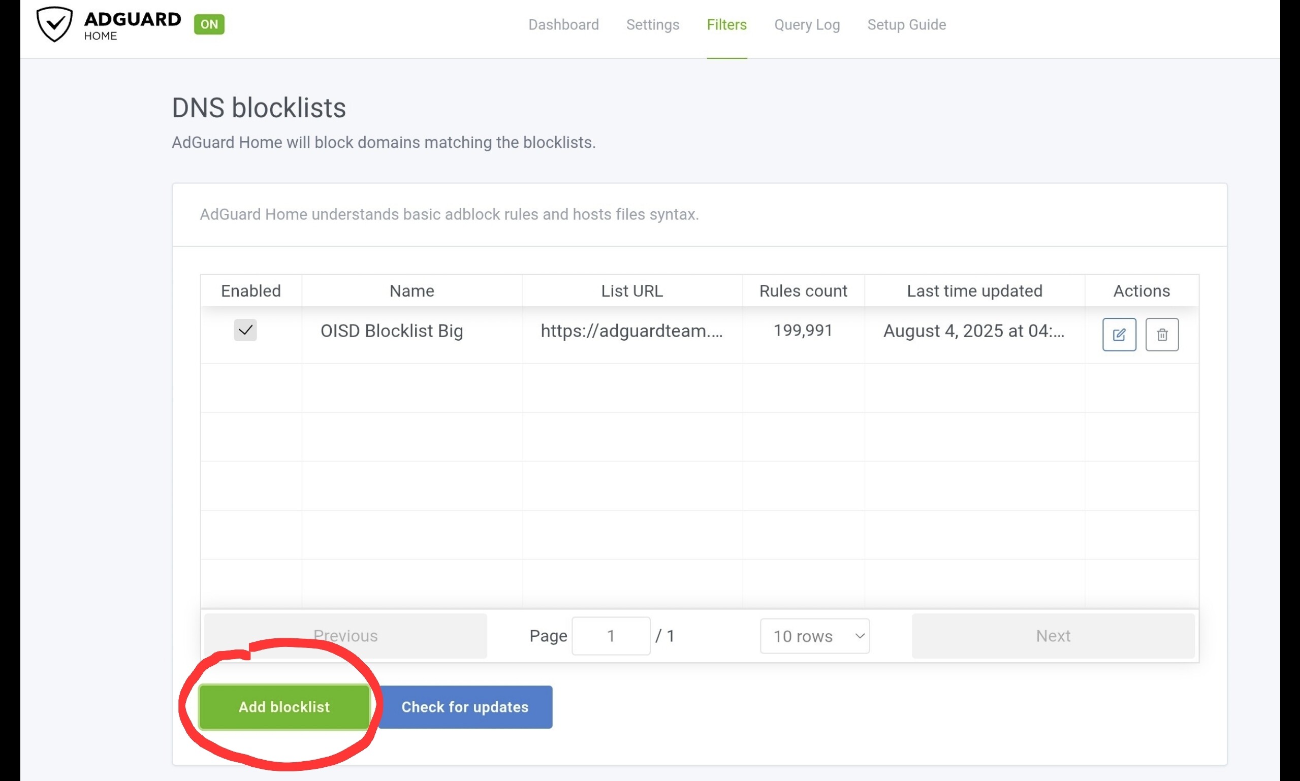

ContolD (paid) and Quad9 DNS block ads at the cloud level. Basically, set it and forget it.The purpose of Adguard Home is to self host and control what gets blocked through the use of block lists. That's why I'm using non-filtering upstream DNS. ControlD (paid) and Quad9 are great, but you don't need to use those AND Adguard Home. They do the same thing at different links in the chain.

ControlD does more than just offer blocklists. It can also help circumvent geo-restrictions. That's why I want to use it in addition to using AGH. ControlD's subscription also doesn't offer all of Hagezi's blocklist or any way to manually add them. That's why I want to know how to use ControlD with AGH.

Can you confirm that I entered and am using the two DNS upstream server entries correctly? It's what I was recommended.
The screenshots show my setup. I use network wide blocking for all devices.

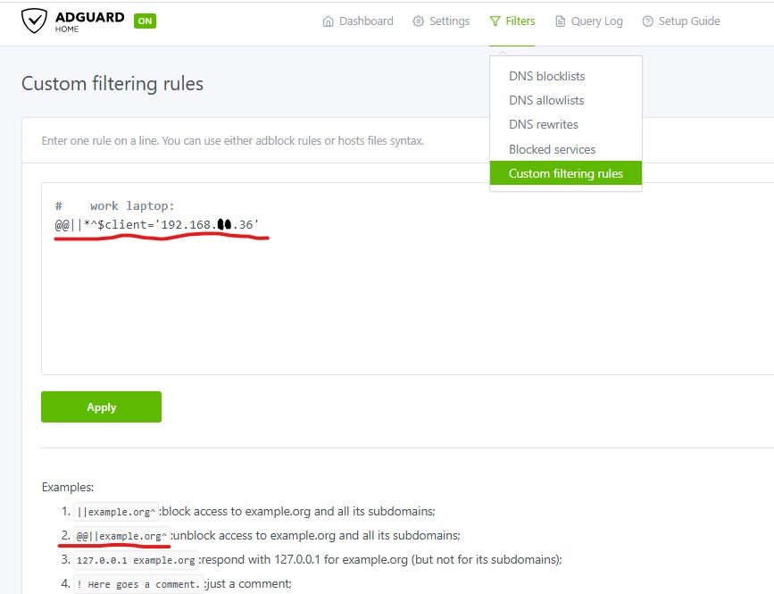

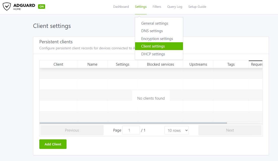

You may be able to pause blocking on that device in the settings. I've never tried that.
How do I add my TV there?

Did you not turn on DNS Rebinding Attack Protection?
The VPN is its own issue. The VPN connection will have its own DNS configured by the provider. Unless your queries are encrypted, you can't bypass that.

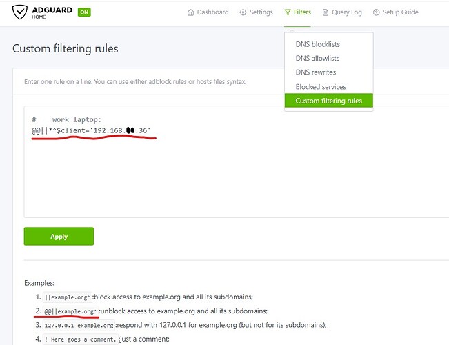

I'm all out of ideas for your use case. I use the following Custom Filter in Adguard for my work laptop. This rule prevents Adguard from blocking requests from this laptop. I setup a static IP in the laptop so it that never changes.
The Upstream DNS servers are where Adguard Home gets the IP addresses for the sites you want to visit. You can use just 1 or many upstreams to retrieve that info. I use 2 (free) public DNS upstreams for redundancy.
If you add more than 1 upstream, AGH will just take turns using them. Without the upstreams, AGH doesn't "know" what FIFA.com's IP address is, for example.
Adding Quad9 or NextDNS to your upstreams kind of defeats the purpose of paying for ControlD. Two-thirds of your requests will answered by Quad9 or NextDNS. You can delete those and just use ControlD's DoH server.

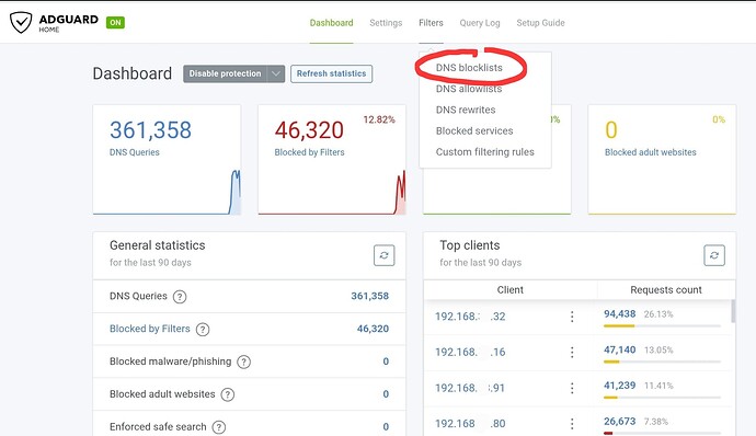

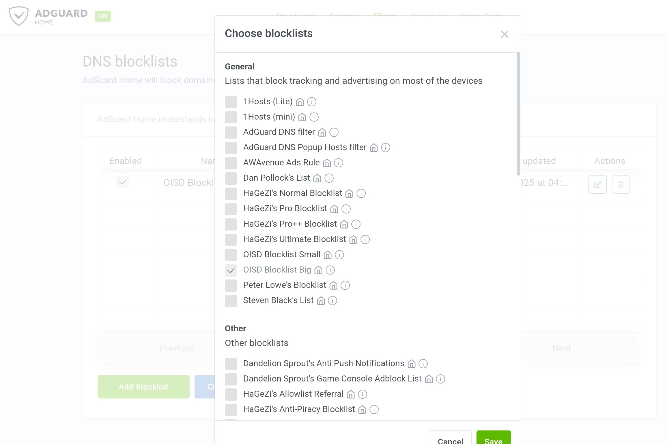

AGH will refuse to load a site, if it's in the blocklist selected on the Filters tab.
That's how I use AGH. My upstreams don't block anything. AGH does.
