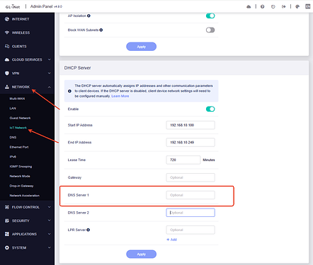

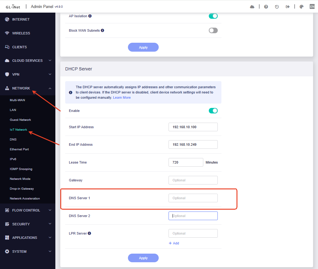

  1. Assign Pi-hole as the DNS server for the IoT network
    Go to NETWORK → IoT Network → DHCP Server → Advanced, and set:
DNS Server 1: 192.168.8.2
DNS Server 2: Leave blank
This makes the IoT clients query Pi-hole directly.

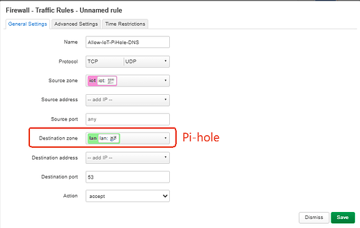

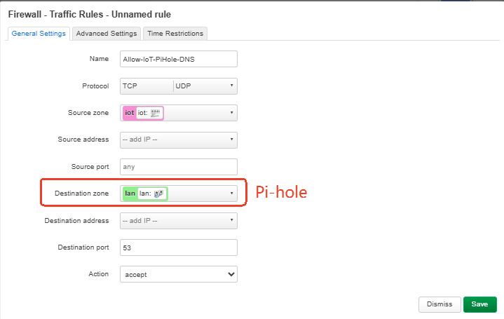

2. Allow only DNS traffic from IoT to Pi-hole
Go to LuCI → Network → Firewall → Traffic Rules and add a rule similar to the following:
Protocol: TCP + UDP
Source zone: iot
Destination zone: lan
Destination address: 192.168.8.2
Destination port: 53
Action: Accept
With this rule, IoT devices can only access the Pi-hole DNS service on the main LAN.
