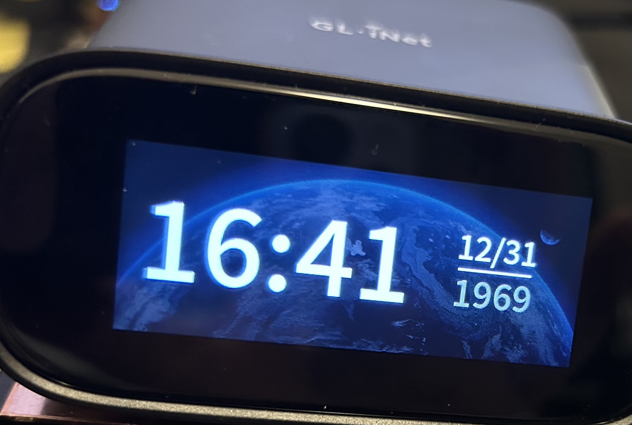

my RM10’s date goes back to 1970 after upgrading to the latest firmware.
no matter what i do, it got stuck with year 1970.

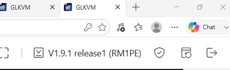

it was runing perfectly fine with previous firmware 1.9.1.

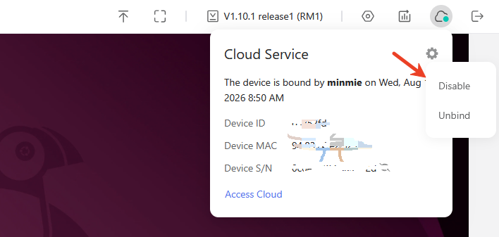

i don’t have a cloud service icon.
Screenshot 2026-08-19 105531
Do you access it via the app? Try using a browser instead—the app may have blocked this button.

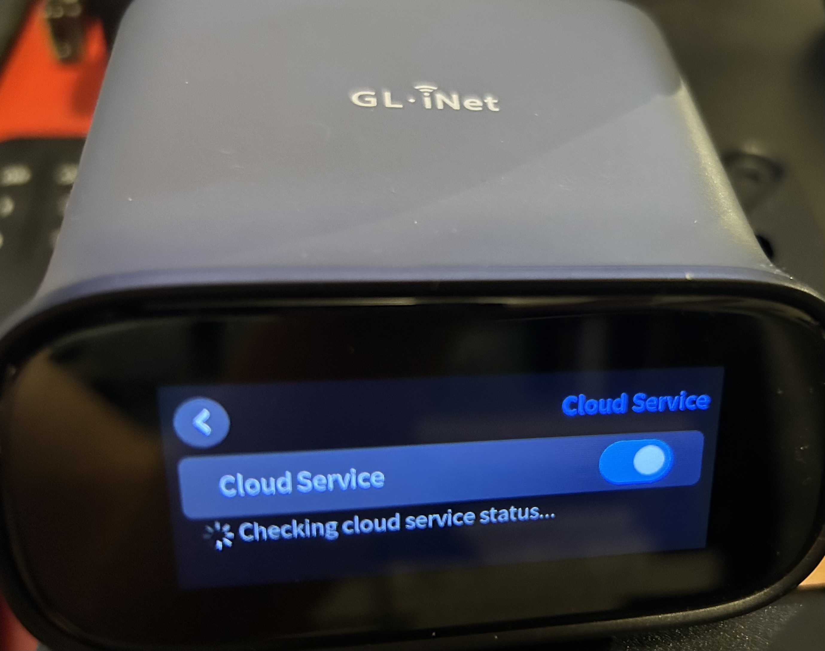

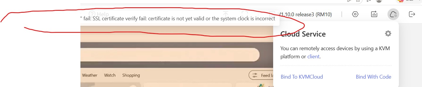

it’s greyed out. when i try to bind, it shows the message in the pic. also, the unit got stuck with “checking clould service status…” message.
Try disabling it, then restart. See if the time gets synchronized. I have a slight suspicion that Cloud's own time synchronization code is interfering with the default time sync. After the time synchronization is completed, reopen the cloud.
