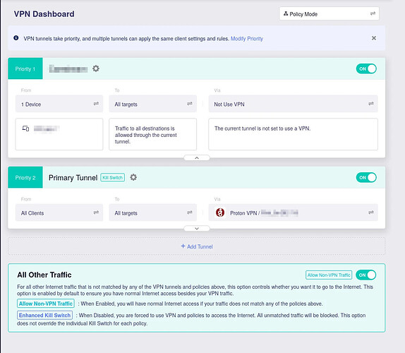

VPN Dashboard Tunnel limits?
Ok I cant for the live of me remember how I got these but going off this screenshot example (I actually have 5 tunnels setup) I was trying to add a 6th VPN client, which added but it forces me to select one of the already existing tunnels. I want to create a new policy but not seeing where/how to do that. Is 5 the max? Again screenshot only shows 2 as I borrowed from another post, I do infact have 5 working, I want a 6th now what am I missing.
I have been told it is indeed a limit.

Since each VPN tunnel may require its own dedicated VPN instance, DNSMASQ instance, firewall marks, and other related resources, we set a limit of 5 tunnels after considering overall system resource usage.
So unfortunately, supporting 6 tunnels may not be possible.
However, if you could share your specific tunnel policy setup, we — or other users — may be able to help determine whether some of the rules can be consolidated.
