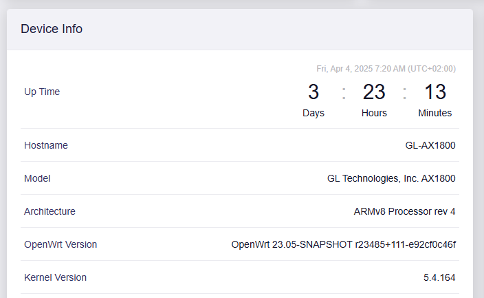

Hello! It says 4.7.0 release8
System -> Overview -> Device Info -> Openwrt version
What does it say?
OpenWrt version is: OpenWrt 23.05-SNAPSHOT r23485+111-e92cf0c46f
This is impossible, you can either have 4.7.0 based on openwrt 21 or 4.7.0 based on openwrt 24
