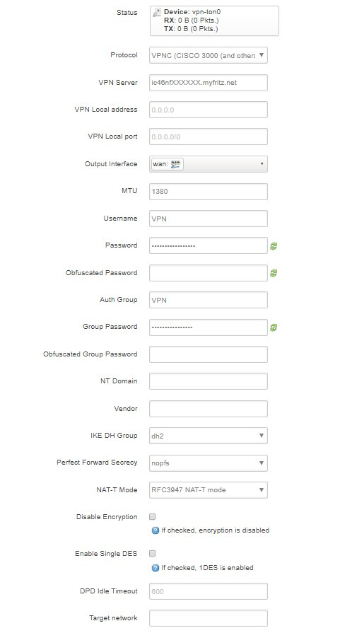

I was able to get this to work. This is what I did:
- Download GL-AR300M16 OpenWrt only 3.0 from https://docs.gl-inet.com/en/3/release_notes/ 50
- Update firmware
- reset to factory default
- connect to 192.168.1.1
- set password
- change IP
- enable wireless
- connect internet (modem) to WAN
Go to System-Software
- update packages
- search for vpnc
install:
- vpnc
- vpnc-scripts
- luci-proto-vpnc
System-reboot

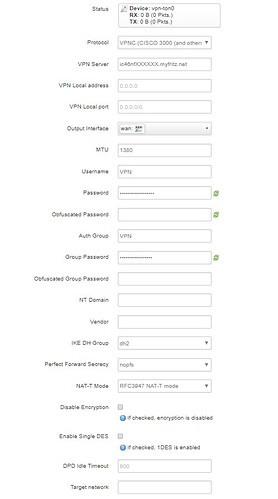

Network-interfaces: Add new interface…
name (4 charachters only! e.g. ‘TUN0’)
protocol: VPNC
VPN Server: enter url of server
Output Interafce: wan
MTU: 1380
Username: name as entered in FritzBox
Password: password for user on FritzBox
Auth Group: same as Username
Group Password: Preshared key as in FritzBox
IKE DH Group: dh2 (should be default)
Perfect Forward Secrecy: nopfs
DPD Idle Timeout: 0
Go to tab Advanced… Make sure ‘Bring up on boot’ is checked
Go to tab Firewall Settings… Assign to ‘LAN’ zone
Click ‘Save and Apply’

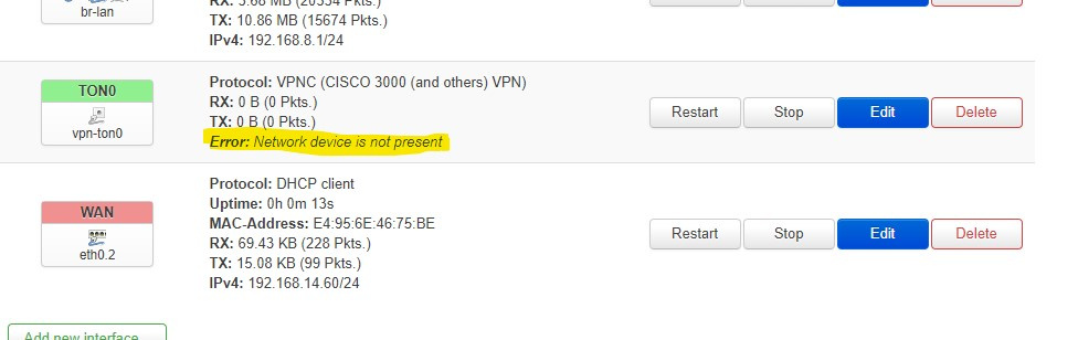

Network-interfaces:
Make sure TUN0 has an IP address and is up.
After this step, my adapter has no IP from the remote Fritzbox!
Where could my mistake be?
Does anyone have a tip?
