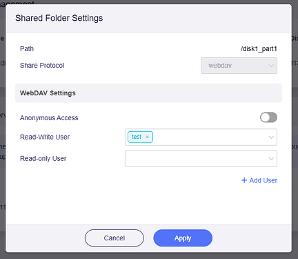

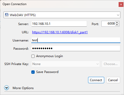

We have tested the MT3000 with firmware 4.8.1 and are able to use the Cyberduck connect the WebDAV server on LAN or WAN without problem.

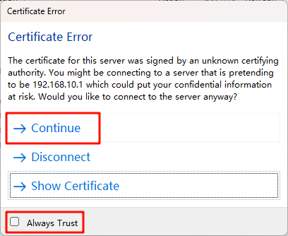

Note: If you are using the HTTPS protocol, please trust the GL self-signed certificate in Cyberduck.
Here are our test settings:

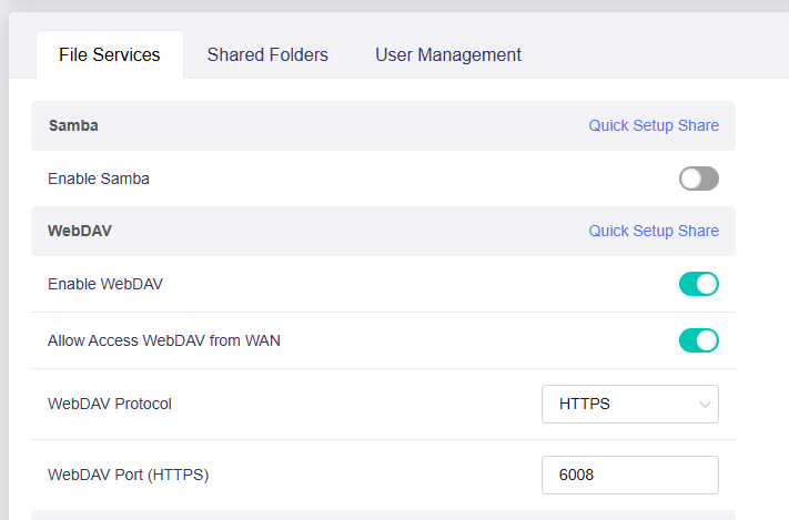

On MT3000:
File services:
Shared Folders:
Cyberduck:
Connection info:
Trust the GL self-signed certificate

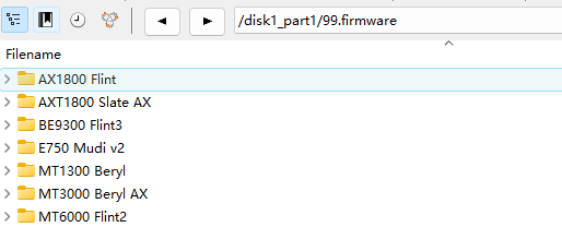

Files list:

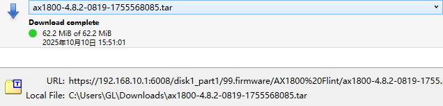

Transfer:
On WAN side:
