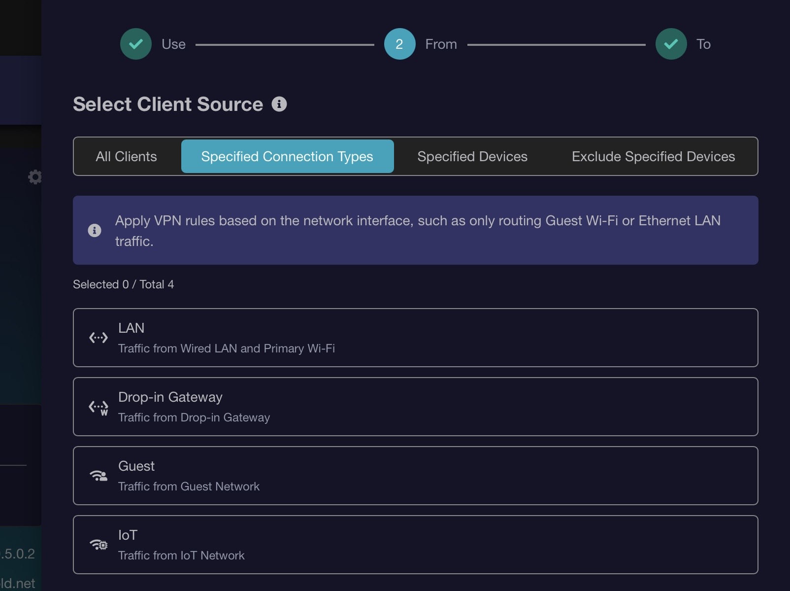

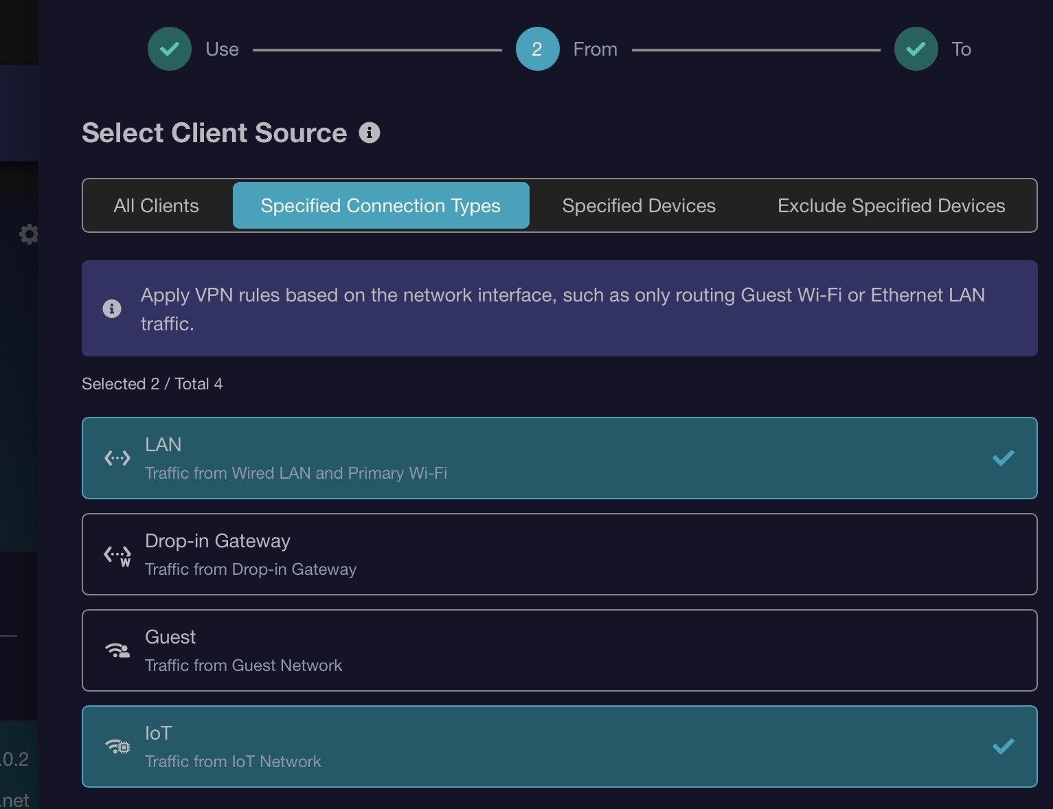

Many thanks for the offer of help I may need it on the IoT Network, but back to the new GUI when you select Specified Connection Types and devices to use a tunnel and apply settings the devices are saved and show a tick and light blue background as before but the Specified Connection Types don’t seem saved in the GUI pic 1 is selected connections but after apply all settings it looks like pic 2 in the GUI not saved, but it must be as my devices would not work through the VPN tunnel, I have tried it several time’s, thanks.

Could you please clarify which router model and firmware version you are currently using?
We tested locally using a Flint 2 running v4.9.0 beta4 (the build released on May 25), but were unable to reproduce the issue.
We were able to select LAN + IoT and save the configuration successfully:

Please check again and see whether the issue is still occurring. If it is, please follow the guide below and share your device with us via GoodCloud so that we can investigate remotely:
Please also send us the MAC address and the router password via private message so that we can access the device.
Hi sorry it’s the Flint 3 not tried the beta on the Flint 2, the devices are saved but not the Connection Types, I did do an upgrade to the new firmware saving settings maybe that’s the trouble.
