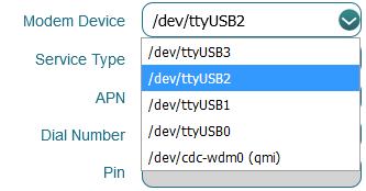

Thanks. I can’t get the LTE modem to connect with that firmware. Am I supposed to select USB2 (default) or the wdm0 entry? I have the EC25 card.
Did you use V2.27 already
There is a auto configuration function. If you reserved old settings you can reset your firmware and try.
