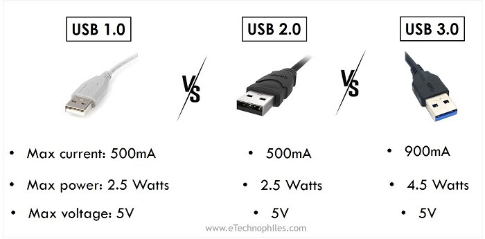

USB A isn’t the way to search. Use USB 1.x, 2.x 3.x or variants of each.
I’d go to the actual open specification, but this may be correct.
The maximum output current/voltage of the USB-A ports for the three models (MT1300, AXT1800, and Flint 1 (AX1800)) are all 5V/1.5A.
