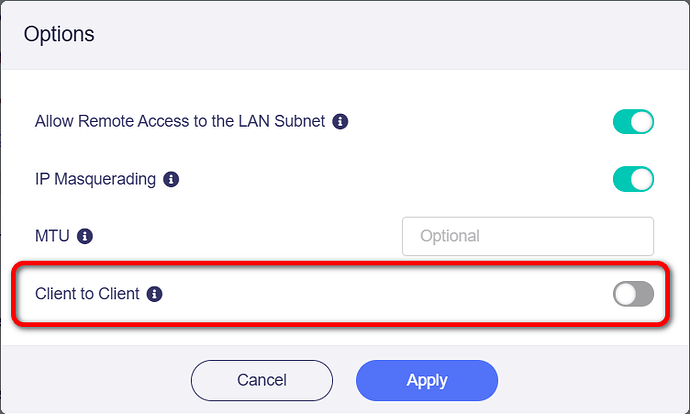

Apologies if this has been answered before but I could not find an answer doing a quick search. I don’t have the chance to experiment with this at the moment but I am due to travel soon and was wondering if someone could explain what this option is before setting up my Wireguard server. The explanation on the UI is also not clear to me. Thanks in advance for any information.
This button is primarily used to control whether two WireGuard clients connected to the same WireGuard server are allowed to communicate with each other.
If your goal is simply to run a WireGuard server at home and connect back to your home network while away, there is generally no need to enable this option.
Many thanks @will.qiu for the very helpful explanation. I thought that this was the case but wanted to double-check rather than ruin things whilst away from my main router. thank you again.
