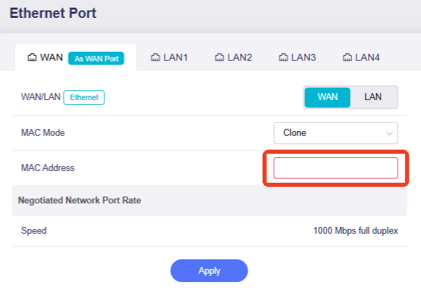

Q2. When should I clone a MAC address?
Some ISPs bind your broadband connection to the MAC address of the first connected device, typically your old router or computer. When you replace your router, you will need to clone the MAC address to restore internet access.
Follow the steps below to clone a MAC address to your GL.iNet router.
Note down the MAC address of your old router (or the computer previously bound to your broadband).
Log in to your router's web Admin Panel and go to NETWORK -> Ethernet Port (named Port Management in some firmware versions). Set MAC Mode to Clone or Manual, enter the MAC address manually, then click Apply.
Reboot your modem (i.e., the upstreaming device).

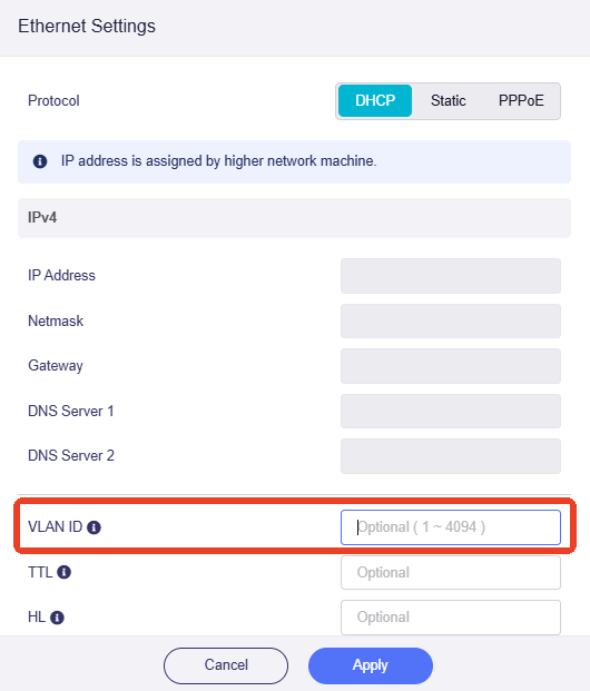

Q3. When do I need to configure a VLAN ID?
Some ISPs require VLAN tagging for Internet authentication or traffic separation, especially with fiber and IPTV connections. Contact your ISP and verify if a VLAN ID is required.
Follow the steps below to configure the VLAN ID.
Log in to your router and go to INTERNET -> Ethernet section. Click Modify.
Enter the VLAN ID provided by your ISP, then click Apply.
