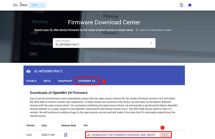

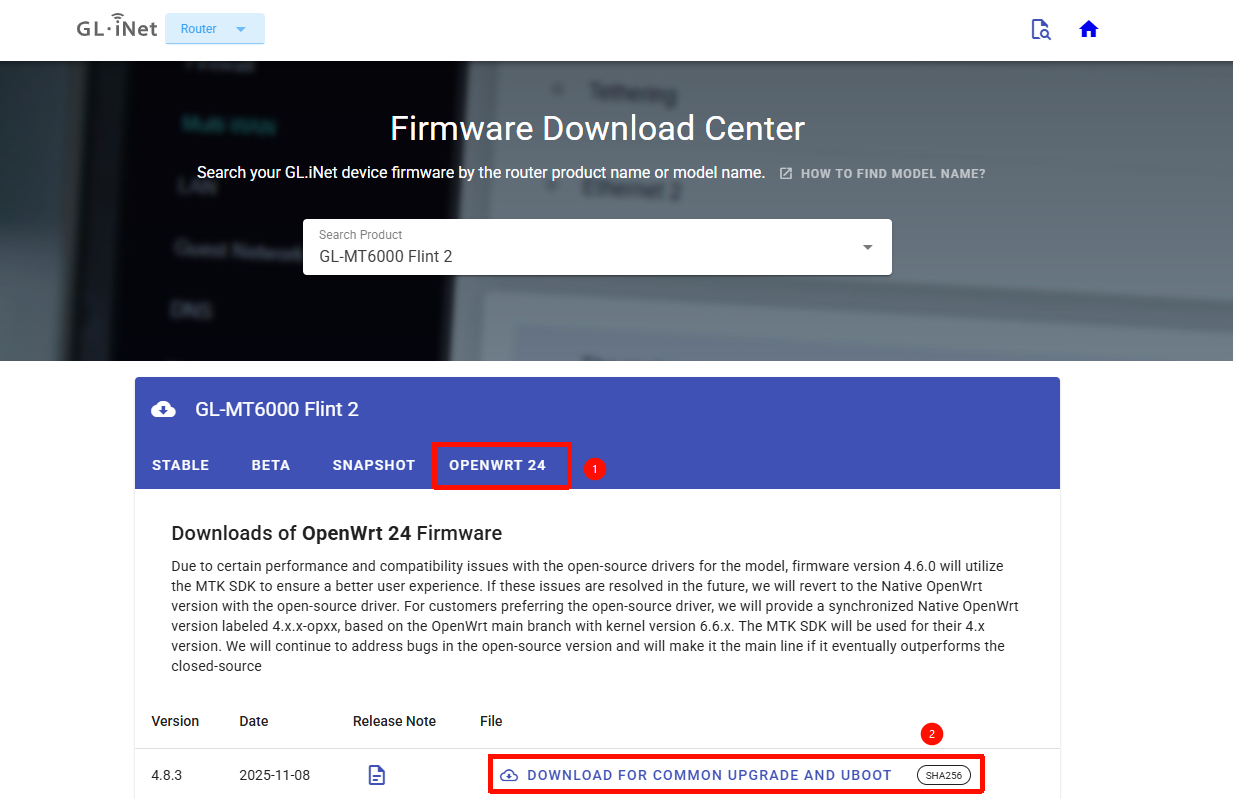

You can download the 4.8.3-op24 firmware from the link below and install it to revert to this version.
Download link:
Upgrade guide:
