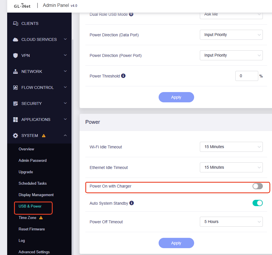

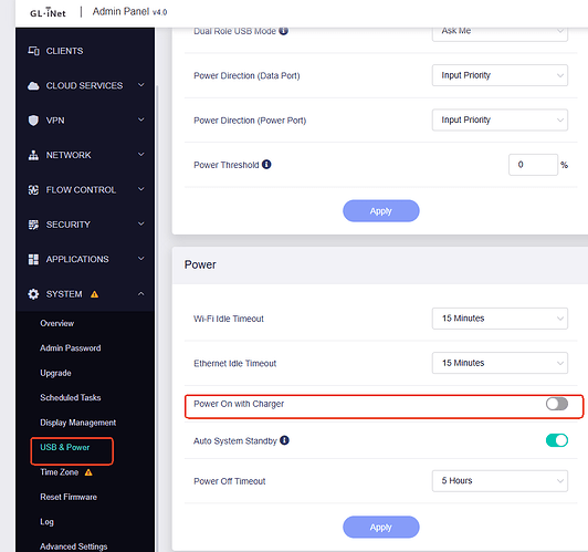

Do you want to charge the router but don't want it to start?
You can try turning off this feature to see if it works.
Thanks. That fixed it. (Although it’s a strange choice to enable that feature by default. Which is technically, disable, because it’s a double negative there.)
