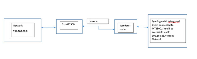

No, I intend to use a Wireguard Client running within a Docker Container on a Synology or maybe within a Virtual Guest at VirtualMachine of a Synology...

You can draw a topology diagram, including the IP subnet. We try to check.
Your remote/left side network uses the same subnet as the home/local network (192.168.88.0/24). That's just causing a loop back into the remote site's network. Change it to something else like 192.168.80.0/24. Then you should be able to set up a S2S without issue if the WAN/Internet link is stable.
Thanks! Unfortunately it is the other way round. The left side is the office network and the right hand side ist remote. And a NAS on the left hand side needs to synchronize the data to the remote NAS which needs to own one specific IP of the office network (...44)...
Well WG is technically a peer-to-peer VPN. 'Client/server' terminology is just an anachronism to make it more approachable. You seem to have a routing conflict causing a loopback at one of your endpoints.
Setting the WG tunnel to a wholly different subnet (eg: 10.0.0.0/24) with the LAN as 192.168.{80, 88}.0/24, respectively, should allow a S2S without much bother. See the aforementioned link.
