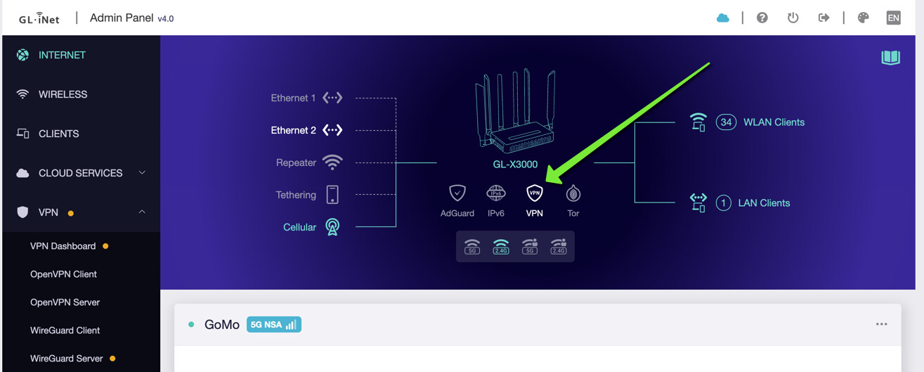

I have a Spitz AX (GL-X3000) and yesterday these warnings appeared on it.

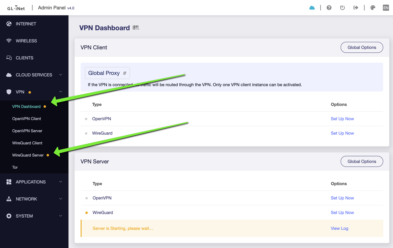

And also here, it seems that VPN is enabled.

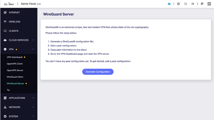

But as you can see from the second screenshot, no wireguard configuration has been generated. Yet for some reason I get these warnings.
I’m not using wireguard, How can I disable it?
  1. Please try to change the browser, or enable the privacy window, and see if the GUI will not display this amber dot.
  2. You can click generate configuration of wg server and then close it.
  3. If above no luck, please export a Backup (Luci > System > Backup/Flash Firmware > Generate archive), and PM it to me, then reset the firmware.

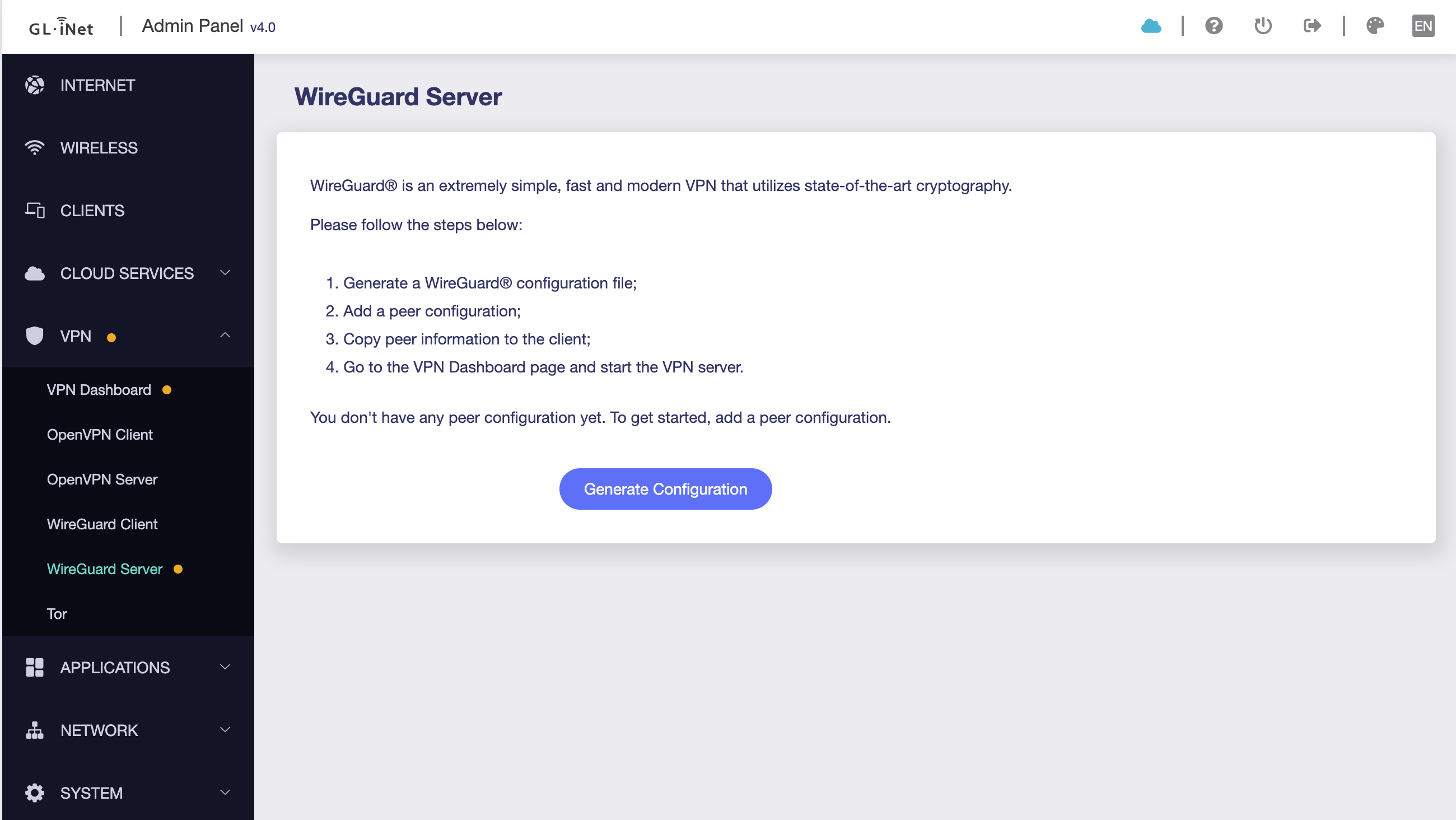

I generated the configuration, stopped the wireguard server and used rm “/etc/config/wireguard_server” to remove the generated configuration. I then restarted the router, but now every time I visit the wireguard server page, I get this message.
This file should not be deleted.
Check if any exceptions after copying the factory configuration:
cp /rom/etc/config/wireguard_server /etc/config/wireguard_server
If no luck, please reset the firmware.
I ended up doing a factory reset. So problem solved.
